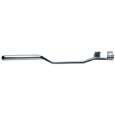

Fancy one from Matco:
Not shown is the half-inch drive hole in the end. For some reason it is 90° to the handle instead of parallel.
Also a simple length of exhaust pipe, or the box end of one wrench slipped over the open end of the main wrench. Care must be taken with the latter so it doesn't suddenly fold up. Frequently necessary for jam nuts on tie rods. On those you can only use an open-end.
