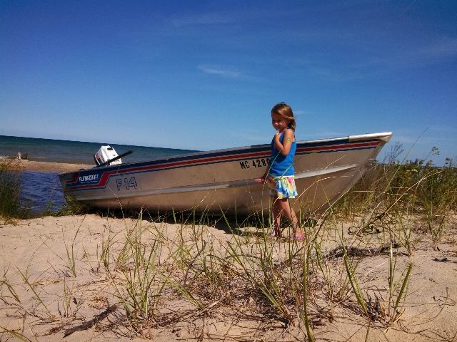

I have an F14. Of course mine was made by Alumicraft, not those Grumman canoe people.
With the 10hp 1983 Honda 4-stroke motor, 2 adults and three small children, it will do 13mph. It's fine for small lake fishing. Paid $1,000 for the boat, motor, and trailer 7 years ago.
Look for obvious damage to the boat. Was it run into a rock type damage. Look at the prop and skeg on the motor. Again looking to see if it was bashed into anything. If it passes that, put it in the water and run it. If it doesn't run, I wouldn't give $1,500. A new motor is between $2,500 and $3,400 for 10hp. The motor should start on one or two pulls with the choke on. It should idle smoothly at a low enough rpm to shift it into forward or reverse without a huge clunk. It shouldn't stall when you shift it into gear. Get a GPS app that shows speed for your phone and see how fast it goes wide open. With two adults on board it should probably go faster than my F14 which is longer and wider. Maybe 15mph?
Good luck.
We even catch a few fish with it.
The major downside is that it will make you want more boat.
Truer words were never spoken.
Posts: 4438 | Registered: January 25, 2013Reply With QuoteReport This Post
