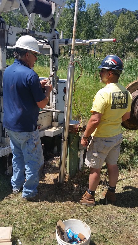

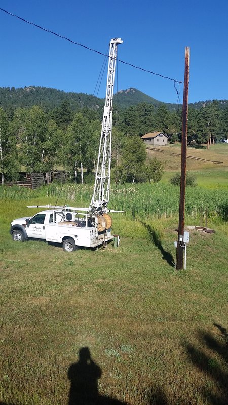

Funny timing. In my neighborhood we have "community wells" for our centralized water system. Two of the wells are on my property, a deep well, ~720' and a shallow well. On the 720' well, the 5 HP pump crapped out 2 days ago. They pulled the pump yesterday and will be installing the new pump today. We use 20' sections of PVC sch 120 with **I think** stainless couplings. I can check today if they are stainless or galvanized. I am pretty sure stainless.
Pretty much what Excam_Man said above.
The pump runs 24 X 7 X 365. For some reason we only got 4 years out of the old one, installed in July 2018. I think we got 7 years out of the prior one.
ETA: yep, stainless couplings, and I confirmed sch 120 1" pipe.
Posts: 6056 | Location: 7400 feet in Conifer CO | Registered: November 14, 2006Reply With QuoteReport This Post

I'm not sure you can pull close to 300' of pipe with a pump attached to it by hand? That's got to be heavy! You certainly don't want to drop it! I'd go with a rig.
