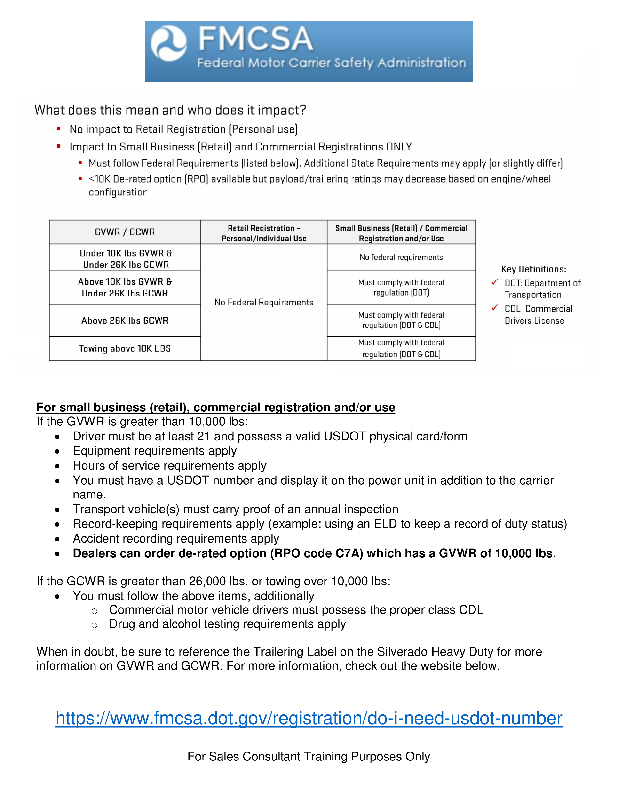

The F250 exists for insurance and state regulatory reasons. Many states tax and regulate vehicles with a GVWR over 10,000lbs differently. In fact, you can order an F250 with a GVWR of 9,900lbs because that's the cut off in some states. Insurance companies do this as well with some calling vehicles with a GVWR over 10,000lbs as commercial.
In reality, the difference between an F250 and F350 SRW is a couple spacer blocks between the rear axle and springs, maybe an extra leaf in the rear spring packs or different rear springs, and maybe tires and wheels. Everything else is the same except the yellow and white sticker on the driver's door jamb.

Hope y'all can read this. Those DOT requirements are for commercial use only
https://www.fmcsa.dot.gov/regi...-i-need-usdot-number
