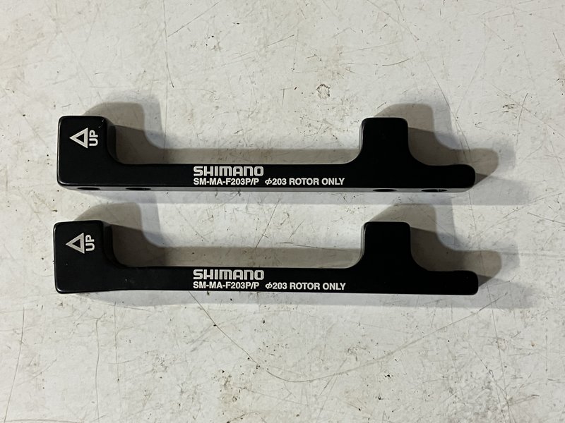

A normal 203mm adapter vs my bent adapter. Eek

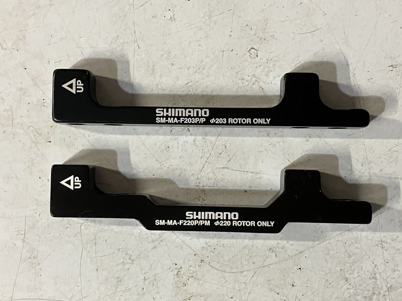

Here is the 203mm brake adapter (top) with the slightly beefier 220mm adapter.
There is only 1.5-2.5mm more aluminum alloy in high stress areas on the top post mount. It’s wild that small amount makes such a difference.

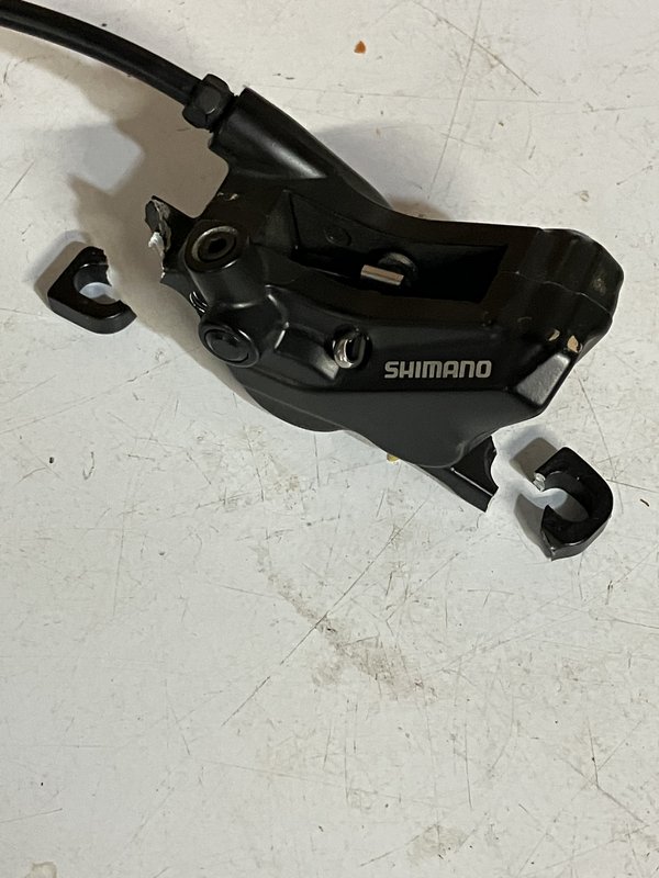

I can buy a new caliper for $53 and bleed it myself but it’s still a frustrating lesson to learn from because it was avoidable.

They were quite serious about the “203 rotor only” warning. Big Grin
I do have to give accolades to Shimano. When the adapter bent and the caliper mounts broke they didn’t fail spectacularly. The rotor moved a bit simulating a bent rotor which was weird because it would come and go. It made me examine the brakes and discover the cracked mounts.
I’m glad it didn’t fall off and dive into the spokes. That would have sucked big time.
