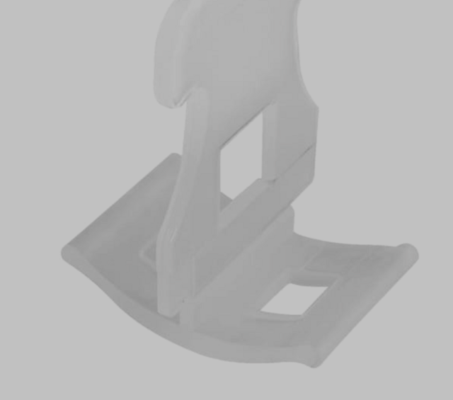

If I may suggest one leveling tool not to use...
The clips (from Lowes) with a curved bottom. On some level it might seem to make sense but in practical use not so much. First is the thickness, second is the curve, spring loaded action. It tends to push the tile apart as you tighten them, because of the curve flattening out. Also it can allow the clip to rock over as you tighten it.
I found them unusable, abandoned them and went commando with good results. NO not THAT commando... rather used no levelers, just 4 and 2 foot levels and a rubber mallet.
Pic of what did not work for me...
