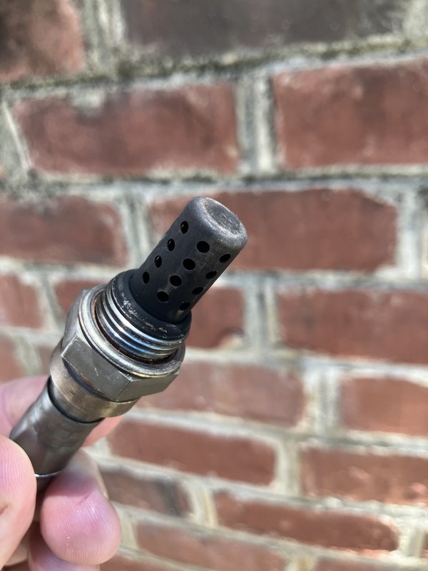

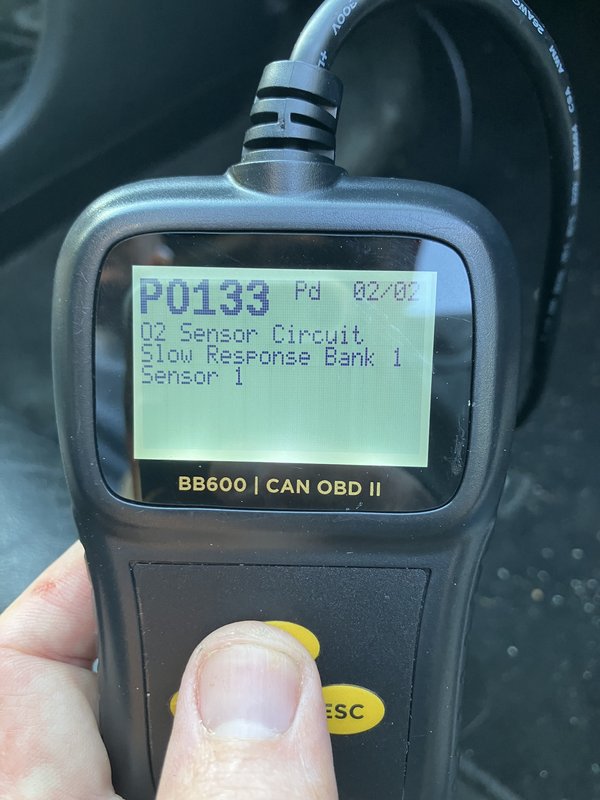

I had my check engine light come on.
O2 sensor upstream or located on the header/exhaust manifold.
Apparently the guys on the Civic/Integra forums have this code come up if they have a modified exhaust to the point that it’s far enough from stock specs to throw a code.
Some people say its an annoying issue that comes and goes and a few said the only way to get rid of it for good is to run a different computer (OBDI) which seems quite involved.
Hopefully it was just an old 02 sensor. For $81 it was an inexpensive part and not worth rolling the dice and ignoring.
I reset the computer twice before I replaced the 02 sensor. It didn’t look terrible but I swapped the Denso O2 sensor out for a new Bosch 02 sensor (I didn’t feel like driving across town for a Denso sensor and spending the extra $8. So far it’s been running pretty good and the check engine light has not returned.

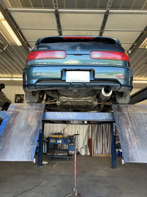

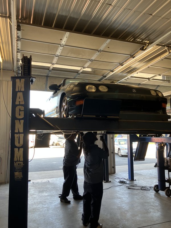

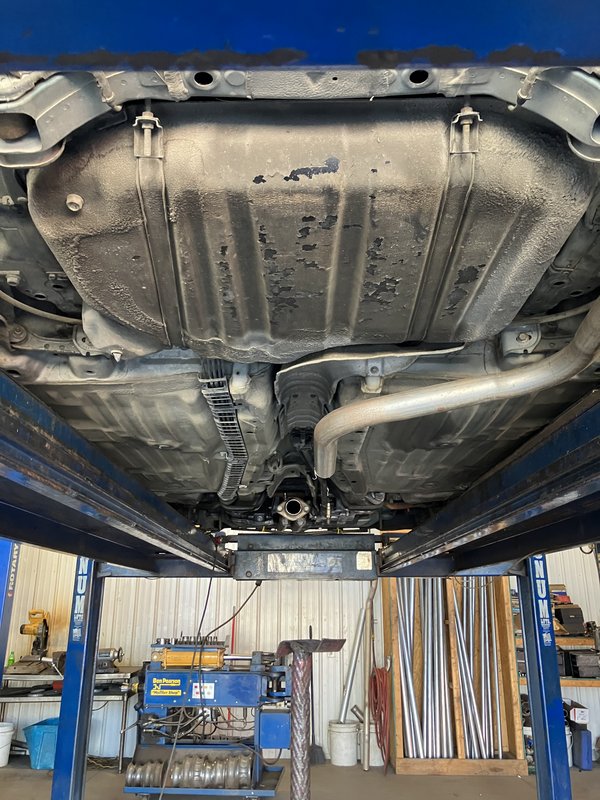

Some pics of my Integra getting the holes in the exhaust system fixed and a new catalytic converter installed. Now it isn’t constantly throwing check engine codes due to the O2 sensor spacer and cat of unknown origin which also caused it to fail an inspection.
Once this baby is 30 years old (in 5 years) all that mess is getting removed as it will no longer require any inspections. Big Grin

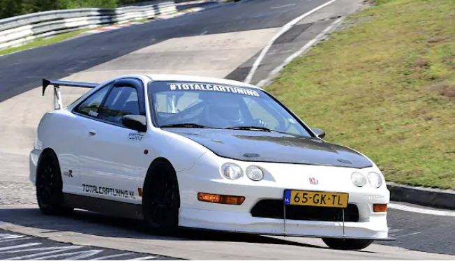

A bit of 9k RPM ITR fun around the 'Ring
Posts: 18782 | Location: Spring, TX | Registered: July 11, 2011Reply With QuoteReport This Post
That video was great! Big Grin
My father sent me this the other day along with the text that he wished he had bought the Phoenix yellow ITR with a $17k price tag that we went and looked at many many years ago. I distinctly remember telling him that these would be highly collectable classics one day to the people like me who love them. Smile
Sometimes it sucks to be right. When I look at the current price tags of MK IV Supras with sport roofs I just shake my head. Always just out of reach….
Posts: 21635 | Location: San Dimas CA, The Old Dominion or the Tar Heel State.  | Registered: April 16, 2007Reply With QuoteReport This Post
What a wild ride! It almost makes me wish my Integra GSR wasn’t numbers matching. That K series is such a fun engine!
This thing has a faster lap time than a Tesla model S plaid. Big Grin
It’s a great looking car too. I know the yellow plates are not seen much in Germany (I believe they are for commercial vehicles) but I love the blue and yellow of that front plate. They look great on silver and white vehicles.
