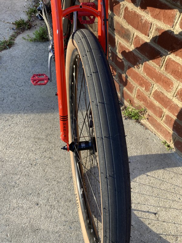

In the unending quest for speed temporary sacrifices must be made. Thank you Marin Nicasio + for the wheel…very cool.

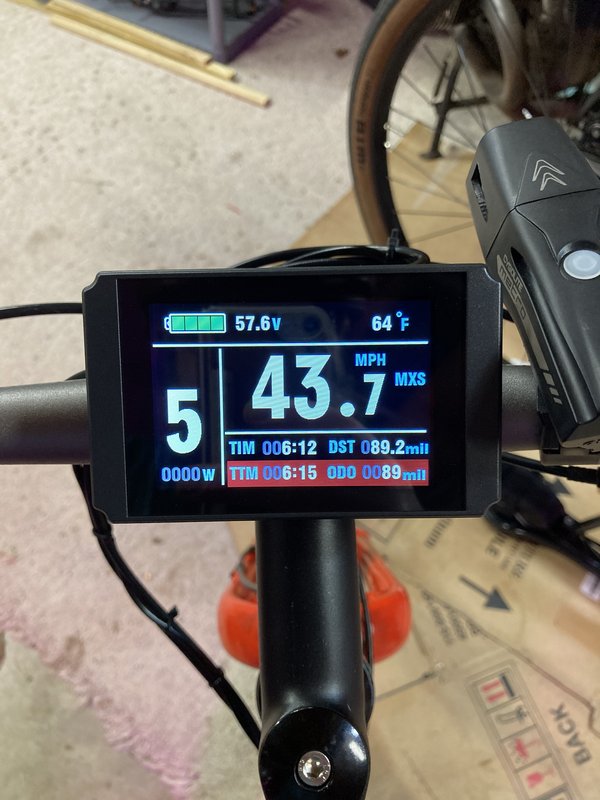

With a fully charged battery and front wheel upgrade I feel like the 39.9mph top speed is about to be smashed. Big Grin

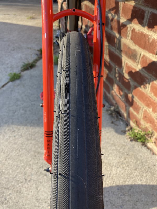

This should quiet down the front tire QUITE a bit.
This slick excels on the street (obviously) and can actually handle light trails surprisingly well too. I’ve taken it on trails few would dare to go with a slick. Big Grin
Those who said it couldn’t be done…that the motor just wouldn’t have enough power well guess what. I was right about running a 27.5in front slick and a 58.8V fully charged battery.
Boom!

VBVAGUY, The bike is currently maxing out around 2000-2400 watts under full acceleration and while climbing a hill with a freshly charged battery (58-56V actual voltage).
I’ve seen reports that my hub motor can handle 3,000 watts for a few miles. It’s gearless and brushless so the only way to mess these things up is to overheat them by running them at a high wattage/speed for miles upon miles or to do lots of stop and then full throttle acceleration pulls over and over. Riding 5-8 miles didn’t seem to hurt the hub for people who were running 3,000 watts from a “1500” watt hub. I take mine up to 2,000 watts nearly every time I ride it.
I recently got a power meter to track amps. At full throttle and on a fresh battery I’m seeing 31 amps max. My build (the controller) can handle 45 amps +/- 2 amps so a better battery that can push more amps will make this thing even faster and drastically increase range.
The high speed is fun but honestly the coolest part is seeing real time how my pedaling will drop the watt usage and increase my range. The bike seems to really cruise around 25-35 with ease and without too much power consumption. Staying around 17-20 mph and pedaling to assist would give this thing an incredible range.

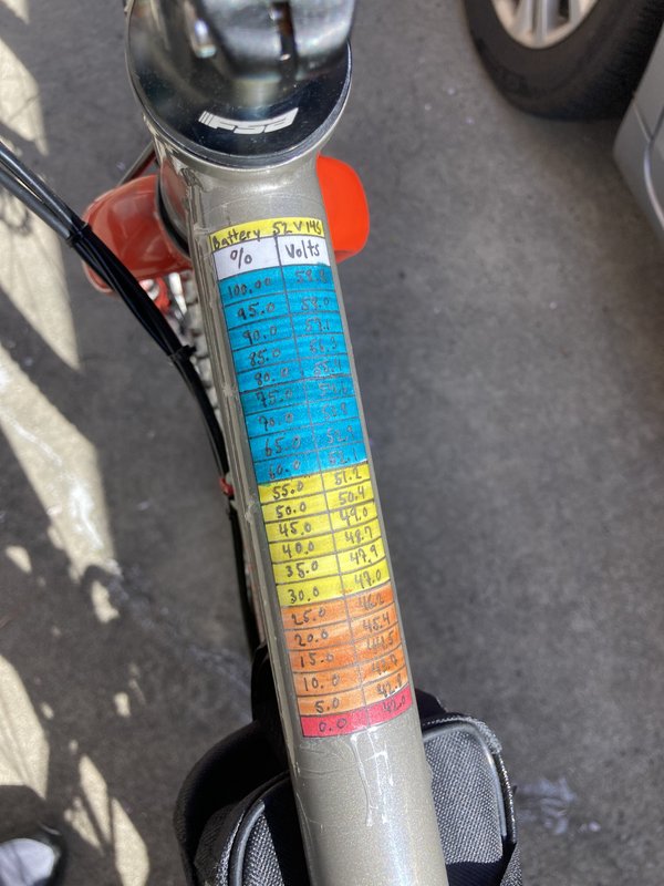

I also made a nifty battery charge scale by hand today to give me an idea of battery life based on voltage.

Nah man I swapped the Maxxis back on after breaking 40. Though that slick would have probably been fine on the trail, the accidental acceleration into a turn was the real issue.
Had I been running a front slick I would have taken the trail MUCH slower, the Maxxis gave me a false sense of confidence in front grip. Hhahahha

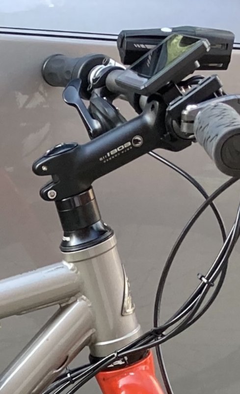

This crash bugged me, in the back of my mind I kept thinking to myself, the damn bike shouldn’t have lost the front so quickly and unexpectedly. It reminded me a lot of when I wrecked an XL frame GT Karakoram with a long stem.

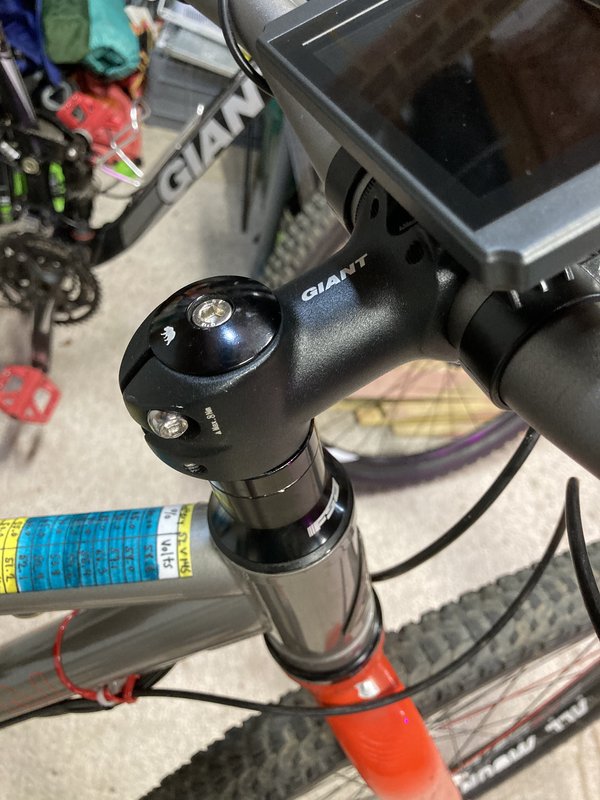

Then it dawned on me, my Giant Anthem full suspension bike that I had ridden trails on earlier in the day has a noticeably shorter stem than my Marin E-bike. The Giant Anthem has an 80mm stem versus the 110mm stem installed on the e-bike.
The longer the stem the better it climbs hills but you put more weight over the front wheel and have a less responsive bike for shredding trails. At speed on trails it is easier to lose grip on the front wheel and slide out/crash with a bike that has a damn long stem relative my short height.

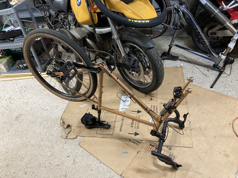

I measured my other Marin Pine Mountain ridged and it has a 60mm stem. Hmmm. I then plucked a 65mm stem off one of my other mountain bikes and put it on the Marin E-bike.
Holy smokes! The difference between a 65mm stem and a 110mm stem is HUGE.. The bike now feels way more responsive and agile. My weight is shifted a little further back off the front wheel and now it feels quite a bit better.
I’m going to ride the same trail soon and see if this stem makes the bike over all feel more confidence inspiring.
I also need to contact the people I bought my kit from because while swapping stems I noticed that the crash cracked my LCD mount. Yay. Frown
Not the greatest stem but it’ll do for now.
A pic of the old stem for reference.
