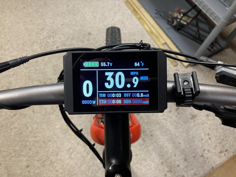

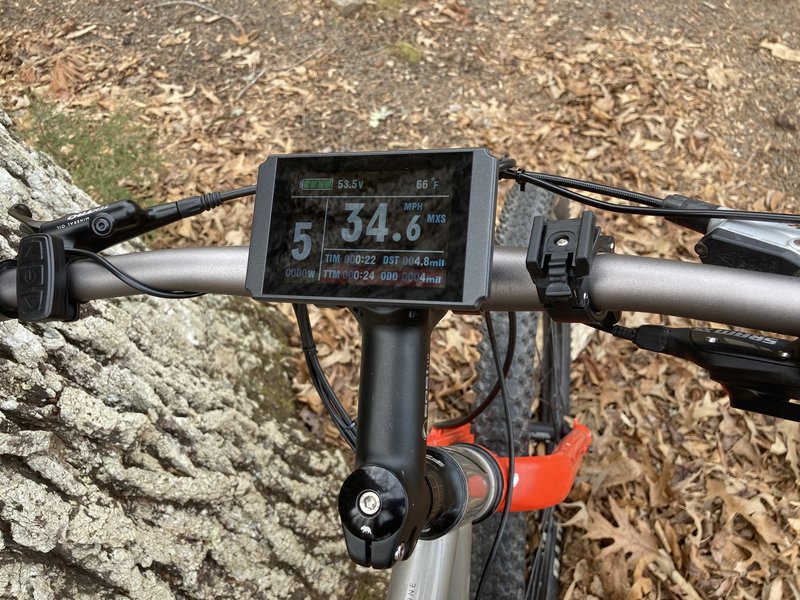

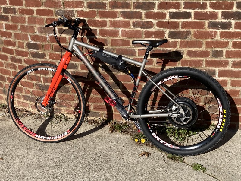

Im going to need a better battery. Big Grin
I was able to hit 35 mph today. My controller is rated for 45 amps max +\- 2 amps. I’m running a 52V 13Ah battery so there is ALOT more speed to be found on this bike simply by getting a better battery that can crank out more amps.
My rear brake is terrible and my front brake is only ok so I really shouldn’t even be pushing the bike as hard as I did today. They will both be upgraded later this week. It feels more like a motorcycle flying through my neighborhood at around 30+mph without even pedaling.
The 5 power levels work brilliantly. Power level 1 keeps the watts low and tops the speed out at around 17.5 mph. Power level 2 goes up to about 22 mph, 3 goes up to 25, 4 tops at about 28 mph and 5 is unrestricted.
My LCD was indicating well over 1500W under hard acceleration, it was handling north of 2000W which I was surprised to see on the screen. The highest I noticed it go was 2400W.
I frickin love this electric bike.
I’m honestly shocked how good it is at hill climbing. It goes 20 mph up the hills in my neighborhood with ease. Pedaling like I’m on flat land to assist the motor (and increase range) as I climb rather large hills is such a unique feeling.

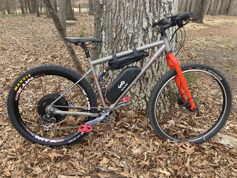

I ordered a few frame bags to replace ugly and cheap looking controller bag. She isn’t the prettiest e-bike (yet) but I am absolutely loving it so far.
A few pics

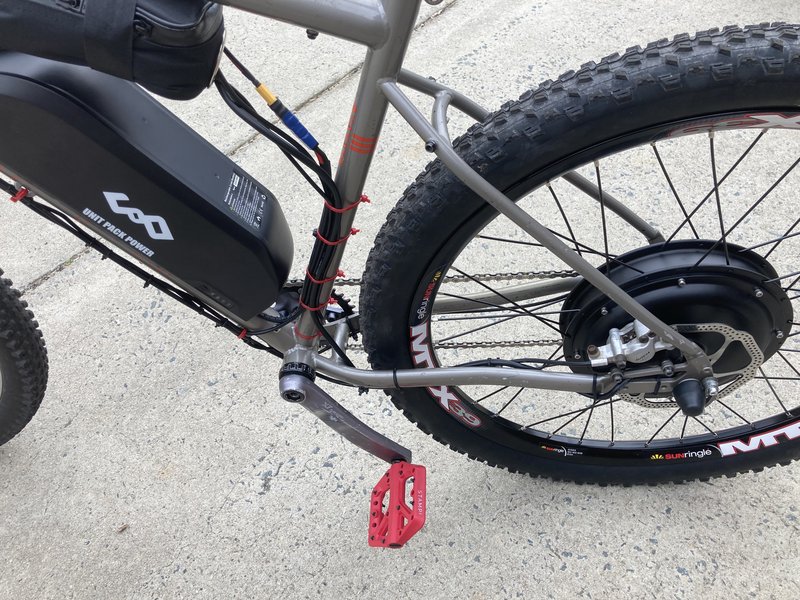

My dash
This pic from my garage the night I finished the build. It shows the colors and contrast a little better than the other pic. You can toggle between actual speed, average speed and maximum speed reached.
Ok, this part is going to be looking a LOT better soon. The new frame bag will attach to the seat tube and hide most of those wires.
A pic from the park yesterday

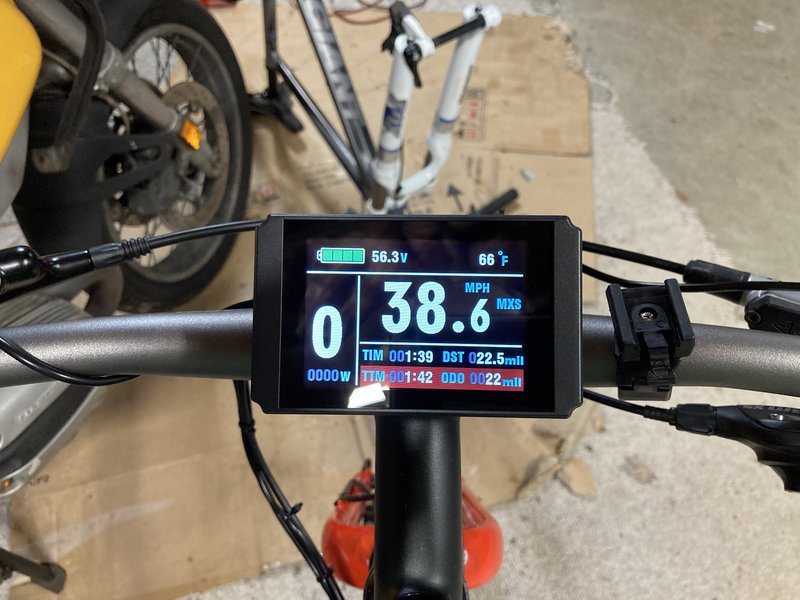

This thing is wild. I think I’m going to have to build another one. It’s practically a motorcycle now. For the first time today I reached that glorious speed where the aero (or lack there of) builds negative pressure and pulled up the back of my t-shirt like a motorcycle does around 50 mph. Big Grin I wasn’t expecting that to happen. Hahahah
I met my son and his friends at the bus stop today and let them take the bike for a very brief test ride on a cul-de-sac on power level 1. I made sure each of them rode it without any power first to get a feel for the bike.
Since it has a dropper seat post the little dudes (middle school) were able to ride it with ease. On power level 1 they were all shocked at the power and acceleration. Now they all want an electric bike and I’m the cool dad on the block for building one. Big Grin
I think the motor has a bit of a break in period because it’s going faster every time I ride it.
37.9 mph basically 38mph was the previous top speed. This speed was achieved today after a bit of riding around. Eek
You can see the Giant Anthem X29 that is donating parts for this build in the background along with a little bit of big bird (BMW R1150GS).

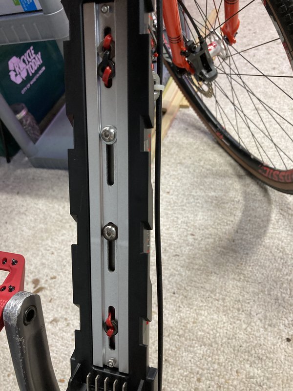

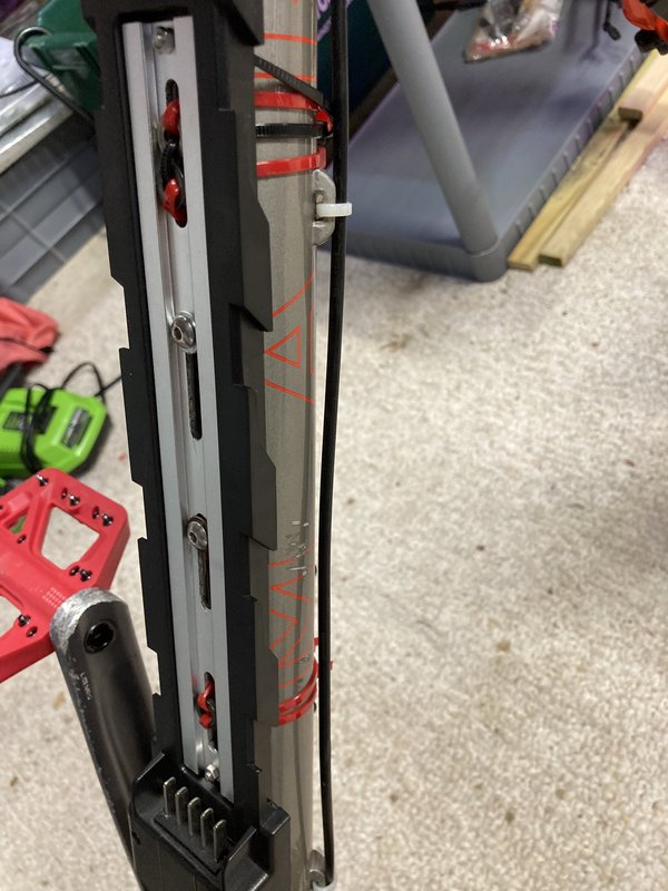

One design flaw I’ve discovered so far is the battery mounts. If you go off-road for even a short time the two screws holding the battery mount try to work loose.
I’ve applied locktite to the screws and used zip ties along with washers to give something extra to hold down the battery mount in an interesting & improvised sort of fix. So far so good.
If I can figure out how to imbed a video I have a short video of my son flying by on the bike. It makes a pretty interesting sound as it zooms by. I am going to film an acceleration video POV style the next time I have to charge up the battery. It really scoots on a full charge.
My improvised zip tie fix.

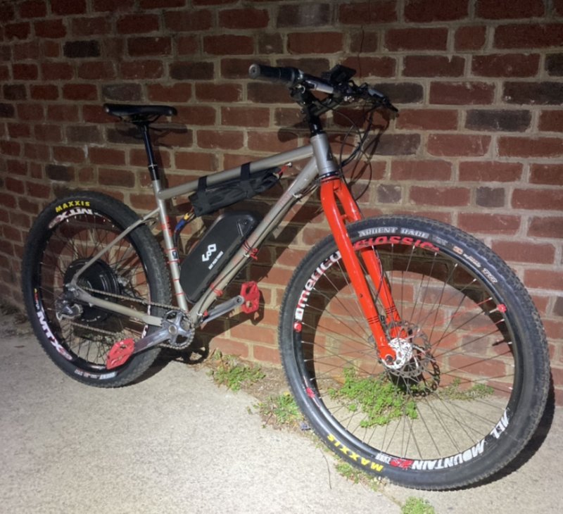

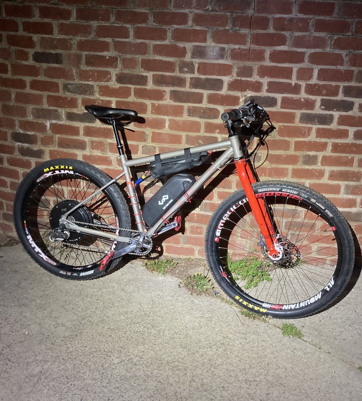

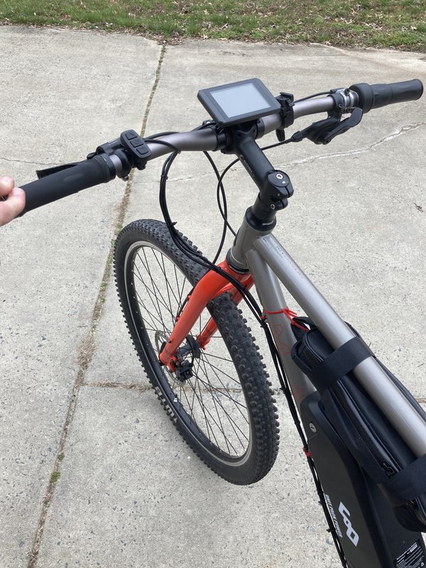

It looks and handles much better now that the super skinny cyclocross style front tire has been replaced with a wider and taller 2.2 Maxxis Ardent Race. It’s a slightly softer compound than the rear tire but I already had it (and a spare just like it) so it made sense verses buying a $60-80 new tire.
Front brakes upgraded to Shimano XTR Hydraulic
Rear brakes adjusted and now working pretty good
Front tubeless tire installed
All that’s left now is to get a better battery and find a bag to hold the controller and wires. The two frame bags I bought recently are just a tad too small, well one is the other is too big. Eventually I’ll find the Goldilocks bag for this bike and it’ll look better.
Pics from last nights night ride. The larger tire might have slowed the bike down a bit. The battery was near 50% so I’m not sure yet how much of an impact the new tire has had on the top speed.
I’m already at 45 fun filled miles on this bike. Cool
