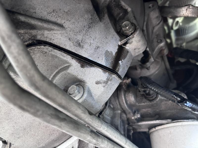

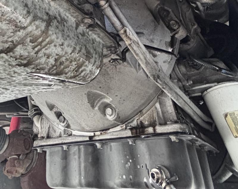

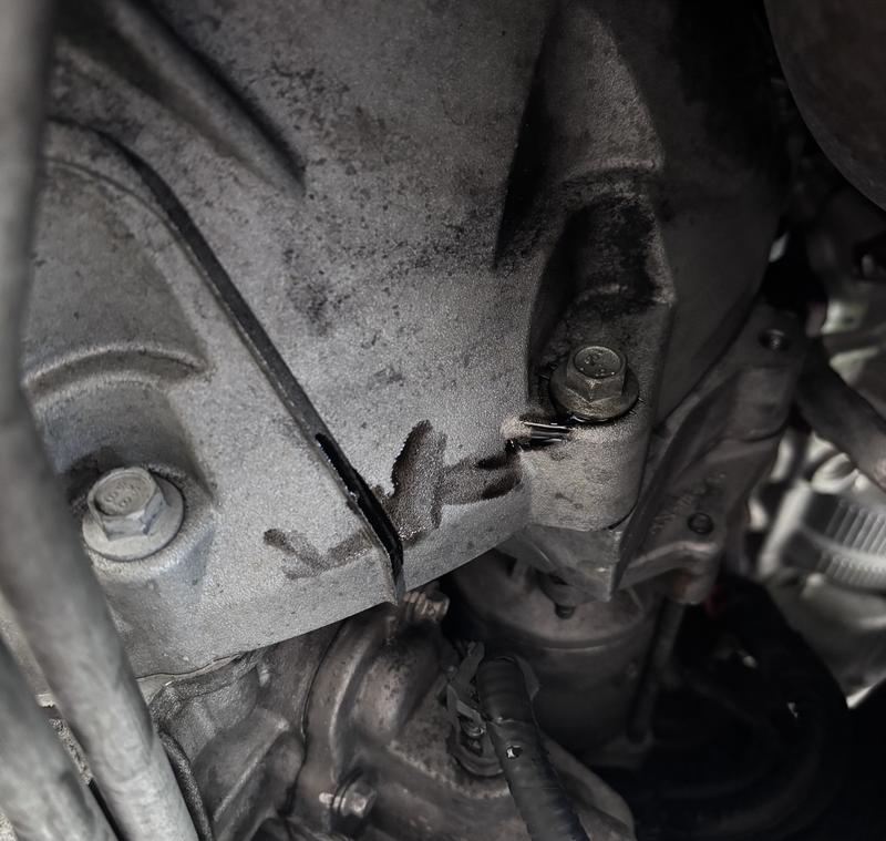

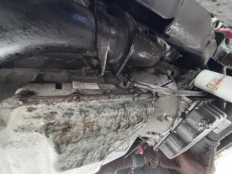

4 miles of gently driving at 65mph:
Another 4 miles of the same:
8 miles and I floored it a couple of times:
This is my F350. I should get this fixed instead of driving 1,600 miles towing the boat back to Florida and then getting it fixed, correct? We are heading back tomorrow with two vehicles. I could leave the truck at the Ford dealer up here and come back for it and the boat later.
I towed the boat up and there was oil spatter on the boat, but the oil level was still good. I drove back and towed the jet skis up, oil spatter again and down a quart.
I replaced the oil separator yesterday. This morning I cleaned everything up with Gunk engine cleaner as best I could, hosed it off, let it dry, drove it, and took these pictures.
I can’t see any oil coming from anywhere else on the engine, but I’m also laying on my back under the truck.

This is the bell housing showing the two lowest bolts that I’m thinking of removing to see if any oil comes out between the bell housing and engine:
Yes, the transmission can be unbolted from the engine, but you asked about an inspection plate and I don’t see one. The bolt at the upper right is the one in the first two pictures of my first post showing where the oil is coming from.

Oil leaks can be tricky to diagnose, especially where space around the engine is tight. They can originate somewhere not even close to where you think they are. That said, I don't believe this is the rear main seal. If it were, the area circled in black would be coated instead of the trickle seen in the first pic. The biggest accumulation, circled in red, is too high up on the engine.
To the best of your knowledge, was it there before you changed the oil separator, or did it show up after? It might be residual. Some oil could have dribbled out and run down the side of the engine. If it was after, spray some brake cleaner in the area around your work, then look underneath and see where the brake cleaner runs down. If it follows that same path, you'll have diagnosed and fixed the leak at the same time.
The red circle is definitely the first place I saw the oil coming from after degreasing everything to the best of my ability. It’s also the only place I see oil coming from. Any oil in the black circle is coming from the red circle.
The oil separator is on the other side of the engine and like you said, there was some residual oil there before I degreased everything. I panicked for a second thinking I screwed up the o-ring. Since degreasing, that area is still clean.
