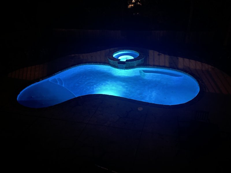

I didn't listen to all the folks I worked with, all-who said don't do it, you don't have kids, you'll never use it after the first year.
They were right, but here's what we have anyway. A salt pool, Pebble-Tec, paper filter and it's been good for the last 17 or so years. We've had several types of pool cleaners, mostly Navigators, never very satisfied with any of them. We started off doing all the stuff on the pool ourselves and hated that. It's a lot of work to keep it looking pristine.
We never considered a pool cleaning service and, again, everyone-all-said don't do that since you have a salt pool, they'll just show up and throw some chlorine in and drive away.
Finally, we decided to find a pool service anyway (going to be gone for nearly 4 weeks and knew what we'd see when we got back), and we were blessed amazingly. The service company we got is family owned, the owner can do anything on pools (licensed, etc) and Brandon, our weekly guy, is great. Shows up, keeps the pool looking perfect, he's polite and personable. Better be for $165 a month.
Here's the one thing we've now added that really helps-an auto filler. The services don't/won't fill pools as that takes them off their route with their other customers too long, but an auto filler, $200 or less from Amazon, adds water when your pool needs it-a wonderful thing in Florida's summers.
