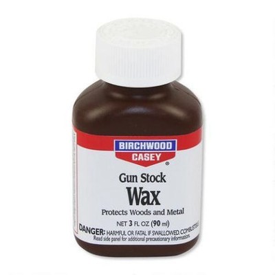

Is anyone familiar with this product from Birchwood Casey? I have used their Tru-oil a lot, and it's a phenomenal product, but a little bit "sticky" to my hands (sometimes that's good, sometimes that's bad). Wondering it this is less so.
(p.s. I cannot just buy it and try it as it cannot be shipped to California.)

I have never used the Birchwood Casey stuff, but I have used Tom's 1/3 Wax quite a bit. Mostly on Garands and such. It smells good, dries quickly, and protects the stock. It's based on the old "Gunny Paste" used way back in the day to protect wood stocks.
http://www.thegunstockdoctor.com/Products.html

Brownells Renaissance wax, used by museums.

Thanks, guys. Are these finishes "sticky" at all? I'm refinishing martial arts weapons, and my hand needs to slide freely, but grip when it needs to. Kind of strange, but neither sticky nor slippery. I'm finding a straight oil finish a bit sticky.

I use Johnsons Paste floor wax or Butchers Paste floor wax on my gunstocks as well as on the metal itself. It is neither sticky nor slippery, leaves a kind of satin finish and protects the metal against rust. No "finger print" rust marks after handling and forgetting to wipe it down. I keep a small rag in the can and wipe it on as needed. Let it dry for a few minutes and buff it off. It is an oil based wax (vs. water based) so a damp rag with alcohol or solvent will take it off.

Renaissance Wax nicely buffed makes a very smooth, slick finish.

I'm a big fan of Tom's. It's sticky/waxy when first applied, but dries to a nice, smooth, waterproof finish after a few days.
Very easy to apply. Rub it in by hand using moderate speed/pressure. (You should feel your hand warming up from the friction). Wait ~30 minutes. Buff it off with a clean old t-shirt. Set it aside to dry for a day or two.

I've used Howard's Feed-N-Wax with good results.

Another fan of Tom's here. Good stuff.

Haven't tried the others but Howard's has served me well also.
Indeed, and obtainable many places including Woodcraft.

Here's a nice video that mentions Renaissance Wax. Also interesting is his side-by-side experiment. I am interested in sample #4, which is a wax-over-oil finish. It obviously provides superior protection; if it provides a non-sticky finish, it'll be the way to go.
I was able to get a bottle of the Birchwood Casey product shipped to me. Will update this thread after I get a chance to try it out.

You can't beat Renaissance Wax. No, it isn't sticky.
