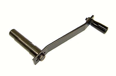

OK a rainy day question that may result in me adapting something into a project.
How much mechanical advantage would one gain by using a simple crank handle on an axle to pull an object with a rope.
Say a one inch axle turned by a 10 inch crank.
Using a rope that winds up on an axle to lift an object.
(Multiple layers of wraps of the rope on the axle can be ignored)
Rope is 1/2 inch so the center to center diameter of a single wrap around a 1 inch axle would be 1.5 inches. So the rope take up is almost 4 inches per turn. A 10 inch long crank would would travel about 62” to make one complete turn.
So it would seem that the simple travel ratio would be about 15 to 1.
But does that equate to a 15 to 1 mechanical advantage for lifting force? (minus friction and inefficiencies etc)
Could a 10 pound force on the crank produce 150 pounds (roughly) of force on the rope? again... (minus friction and inefficiencies etc)
Here is a photo of a simple crank on an axle for an example of what I'm referring to.
