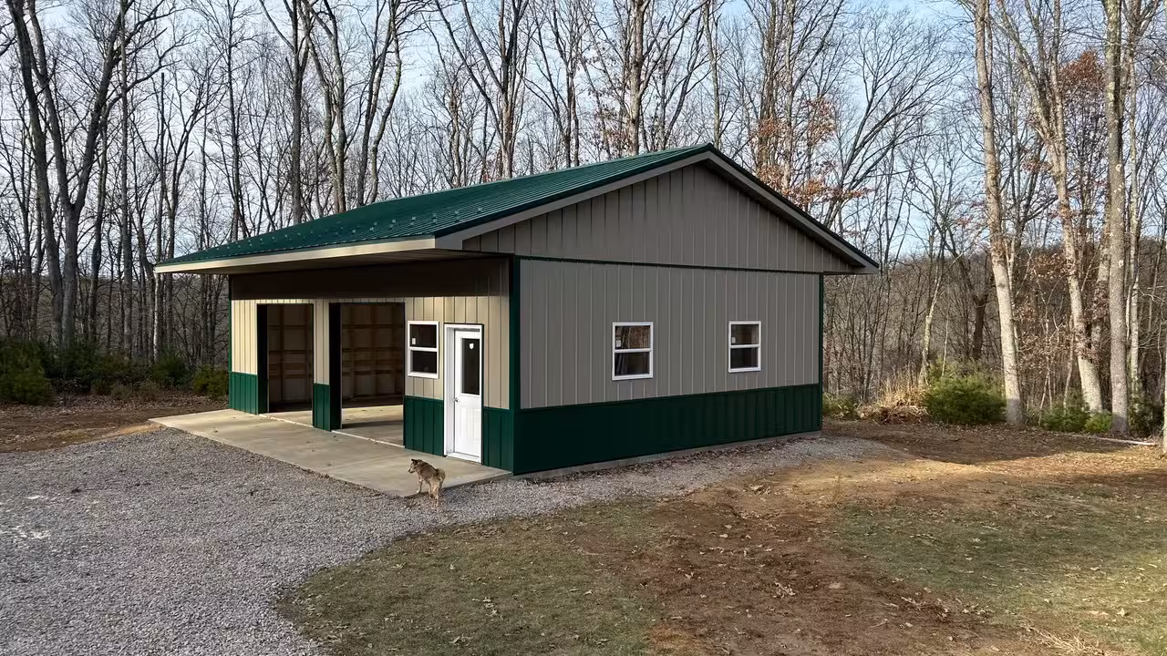

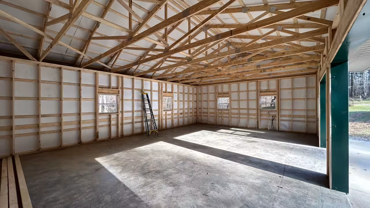

Being short of storage space I sketched a garage/out-building on a piece of paper and gave it to "Mark" an Amish fellow for a quote. (I already had the slab put in.) It came in about what I guessed so I told him go ahead. No money up front, he said "you can just pay when we're done".
It was a pretty simple build, 36' x 26' x 10 high, using 2 x 6's on 24" center and trusses on 4' center, with purlins added to attach the metal to. 5'overhangs F&R with 1' on the sides. Everything covered in metal with thin reflective foam underneath to stop condensation along with the worst of the cold and heat. I had already run a wire out and up through the slab for lights and a few receptacles but it'll be unheated.
Lumber had already been delivered Friday. They showed up early Monday, Mark along with his crew of 4 other Amish, plus a driver (they don't drive other than buggies). The driver did help some, mostly carrying and picking up. They all smoked but there were no "smoke breaks" and no cell phone use, other than Mark when he had to order metal etc. It was a pleasure just watching them put this up. Mark didn't need to give many orders because everyone pretty much knew what to do. They finished Wednesday afternoon so 3 days. I thought I'd share some pics of them putting it up.

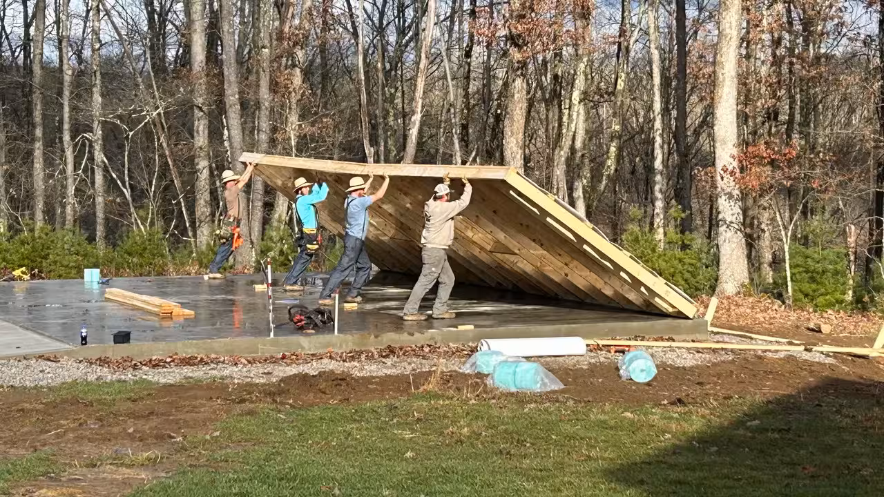

Day 1
Mark in the green shirt.

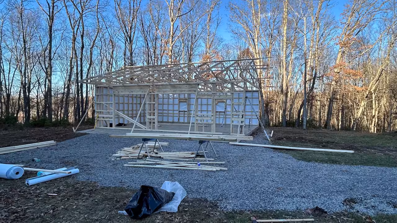

End of day 1.

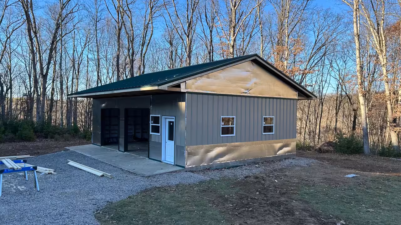

End of day 2. (I was gone much of that day)

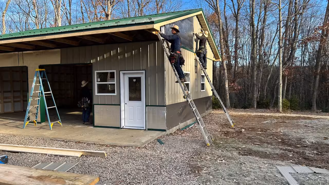

Day 3

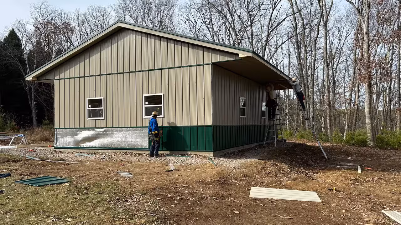

Looks great, hey is that Amish guy putting up siding using an electric drill, is that approved or is because it's a battery drill it's ok? Big Grin

It's interesting what the different Amish clans subscribe to. These guys have no electricity in their homes and can't own power tools so they rent them.

The two color set-up is nice looking

Very nice. Did you order the trusses, or did they build them on site?
Posts: 13722 | Location: Florida, Northwest of the Mouse | Registered: November 02, 2008Reply With QuoteReport This Post
Picture of ridewv
Thanks Artie. They had the trusses premade and delivered. And they manhandled them up w/o a lift.

It looks like a quality building. That slab must be a foot thick. And 2 X 6 construction is a strong building. What are the objects atop the finished roof?
