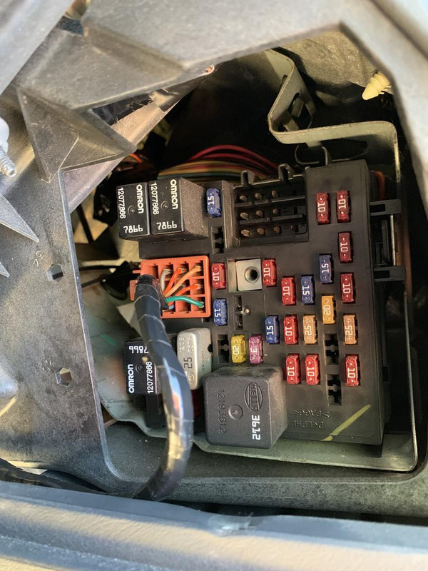

Finally Solved!!!
Got some time to devote to this today and figured I would start at the fuse box.
So went to look under the dash at the fuses to work the other way and a wiring harness seemed out of place above the parking brake pedal.
After tracing it to the fuse box turns out it was the drivers door harness.
My mom had the truck for a bit and the parking brake cable snapped so she had it replaced. That harness runs with the brake cable behind the fuse box and drivers kick panel trim. I am guessing Instead of putting the harness back they just draped it on top of the parking brake pedal so at some point when the parking brake was pushed it must have pulled the wires enough to disconnect. Because I rewrapped the harness finding no broken wires and ran it properly plugged it back in and everything worked.

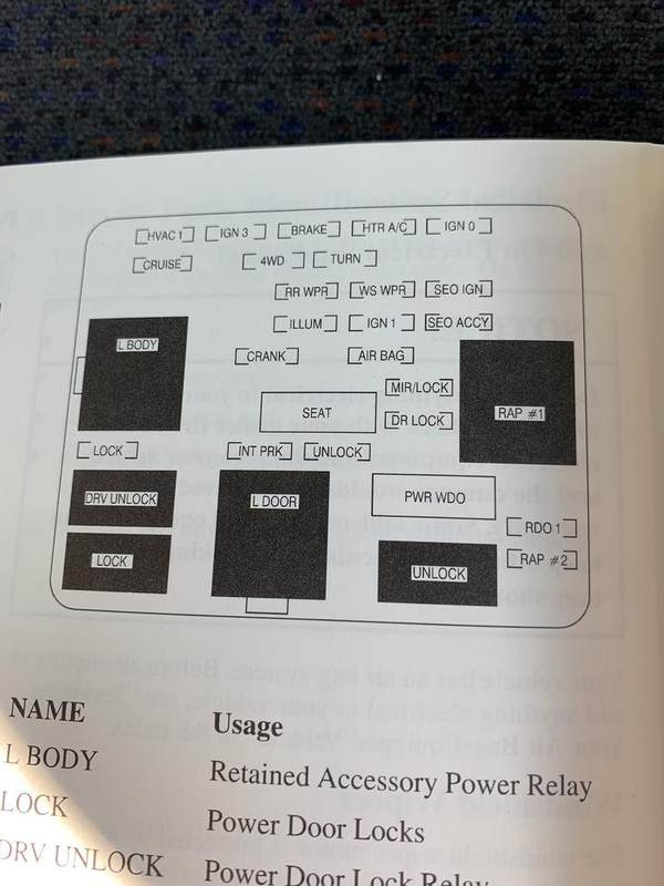

So all my power stuff works again but this looks strange to me.
Seems I am possibly missing a relay.
Says LBODY Retained Accessory Power Relay
Wondering if it is for a fancier model that has some extra interior goodies.
I have the Z71 Off-road model but not with the upgraded interior package.

I think its a wiring harness connection for stuff you don't have.
Thread discussing a 2002 with a picture of the hole populated.
https://www.silveradosierra.co...lverado-t603305.html
Posts: 902 | Location: IL | Registered: September 08, 2004Reply With QuoteReport This Post
RAP (Retained Accessory Power) is the thing that lets you listen to the radio or operate the windows for 30 mins after shutting off the vehicle, or until a door is opened.
Your Silverado should have that feature, regardless of package level.
