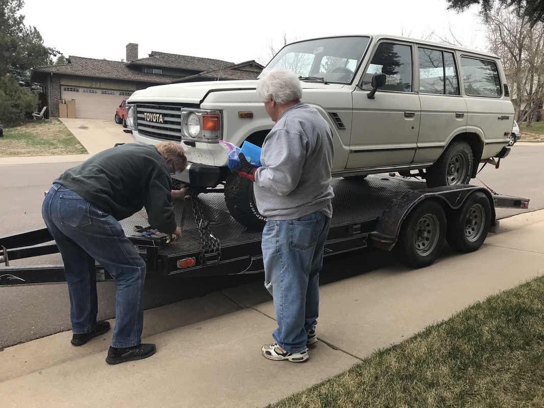

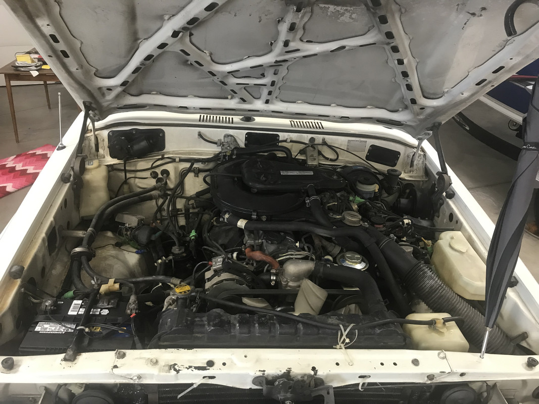

I picked this up recently. Never had one before, not sure what the plan for this one is. But for now I'll be cleaning it up as best I can and evaluating it. It has the inline 6 and 234k on the clock. It's a one owner with not too much rust. I don't think it's seen the inside of a garage until I put it in mine for a few hours to work on it. It's a 1982 so it has some age issues with rubber etc.
I guess I better start YouTubing and reading and see what I should do with it. Not sure if I'll just play with it and flip it, or really try to fix it up.

That's a great looking 60 - Appears to be very stock, original, and in pretty good condition (minimal rust for a 60!).
I'm a huge LandCruiser fan, and have a white FJ60 as well. Mine is *far* from stock, however. I'll upload a post a few pics in another reply.
My suggestion for yours, assuming there's been a lot of "deferred maintenance" as they say...would be to get it running, replace the hoses / vacuum lines / rubber bits under the hood that are old and cracked.
Keep the Aisin carburetor, don't be tempted to swap it for a Weber! If it's bad or needs rebuilt, there's a guy who sells new (but from overseas) replacements...meaning you'd need to de-smog the truck, as it doesn't have the USA smog provisions. Search for "City Racer LLC". His business is sourcing hard to find OEM replacement parts from the Middle East, I believe.
Then I'd go through the brakes, and rebuild the front axle (I'll bet the birfield joints are either empty of grease, or they are filled with grease + oil mixed (which is no good)).
"Cruiser Outfitters" (based out of Utah) sells a good OEM rebuild kit (axles seals, bearings, shims...all the stuff you'll need to do the job). It's a messy affair, but considered a TLC "rite of passage".

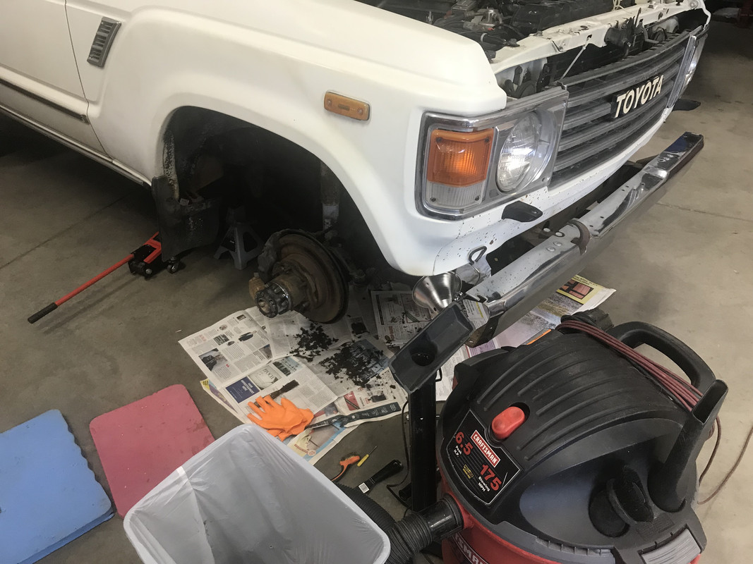

Bone stock everywhere so fa..
Cleaning layers of junk off.
