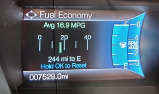

I have a 2020 F150 King Ranch with the 3.5 eco and the full blown trailer package, it has the dual port motor compared to the older single port design. I pull a 3500lb boat fairly easily and so far no issues. Did a road trip to Nebraska and back and averaged 16.9 going and 18.2 running mostly 82mph. Others talk in the 21+mph range. With my tow package I doubt I'll ever see that. Otherwise the dealer and truck has been good. Definitely a nicer more comfortable ride than my 2013 Ram Laramie with the 6.7, but then again I'm no longer towing a 5th wheel.
