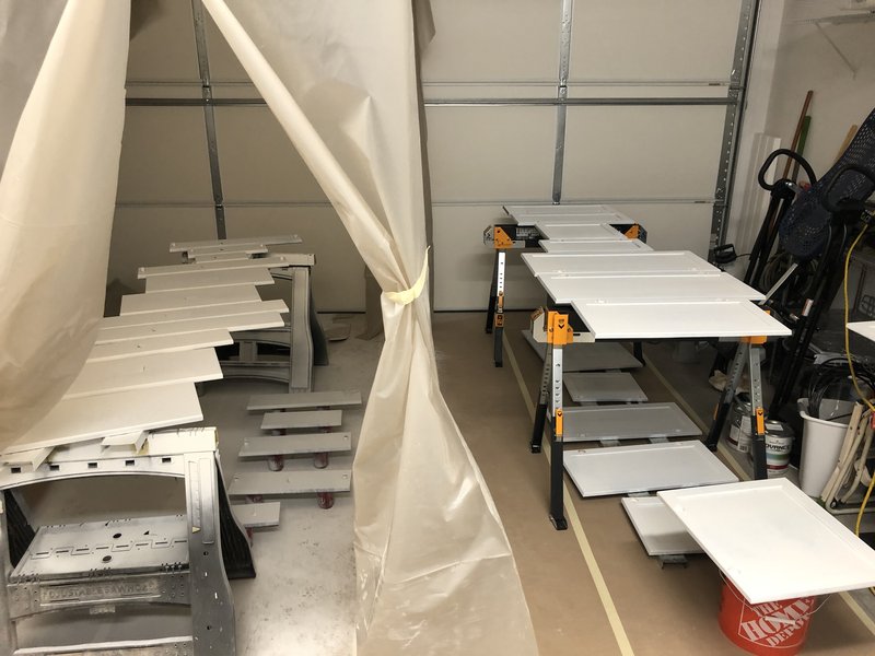

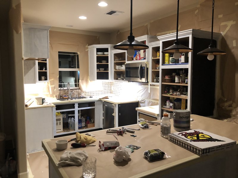

Bro, I don’t mind the rolling that much, and the spraying, once I found my balance with the universe and the sprayer, is all good.
I hate masking shit off. I mean it’s super detail oriented, and the results rely heavily upon it. It’s annoying and it’s not easy. It’s a goddamn art, and I’m not an artist.
That said, I took forever masking everything off, and there is a bit of satisfaction when you can let the paint fly and give zero fucks because everything is well covered.
Now unmasking will be a challenge because I’m sure after a coat of primer and two of paint, the shit will need to be razor cut. Hopefully it peels off, but I have only had that kind of luck when it’s one coat and immediate removal. So unmasking will be almost as annoying.
But damnit, I’m alive and healthy and my wife is giddy with excitement over how it looks. And it’s only got primer on it now.
I have to pick up some dinner. After that, I’ll snap some pics.

I’m sure there will be a lot of advice on primer and how to apply it. This has worked fine for me in the past. Two coats of paint and life is good.

Looks good from here.......Be careful though.....if they turn out too good....your wife will want you to paint them grey next year.....hehehehe......

I like the original dark look myself.
I'm already hearing from kitchen remodelers here (TX) that the all-white kitchen is so 2018 HGTV.
Just my luck that if I paint my cabinets everyone will want dark ones.

Hats off to you bean cooker for the skilz, but I think the original dark cabinets looked awesome.
Be careful she may want new backsplash an flooring because yall had warm tones and white is a cool tone. Ask me how I know!

if you leave that yellow tape up too long you will have a horrible time getting it off or lifting everything below it. green is my favorite or blue being second.

I second this, I think those cabinets look good with the backsplash. Once you go white it seems like it will be too dark...
I'm with you guys. I like the dark look but I can understand wanting a change.
Count me in as well. I’m sure the white will look great as well. I guess I watch too much HGTV because every kitchen looks the same. They all have white cabinets with grey veining in the granite and 50’shades of grey worth of accessories.
So Ken at the local paint store assured me that we are good for six days. I was skeptical and he said I’m good for six days interior. Exterior, buy better. If I need more than six days, buy better.
I rolled the dice.
I hope I rolled a 21 or craps or a full house, or something related.
As long as that shit ass tape doesn’t turn to brittle, paper fuckol of removal we are good.

XLT, I’m now starting to get nervous about the tape. Today should be the final coat, and I’m definitely worried about the tape lifting the paint. Razor knife at the tape edge prior to pulling it up?
Ador, your kitchen is easily twice the size if mine. Honestly, the painting part is not too difficult. The hard part, and time consuming part is all the damned masking, and prep work of the wood. TSP wash, rinse. Light sanding, dust removal, etc. if my kitchen was as large as yours, I don’t know if I would have tried to tackle the job. The part where I am running into issues is space to paint. There are so many doors. I’m doing both bathrooms and a hallway cabinet as well. So having room to lay out the doors after they are sprayed so they can dry, is where I am having issues. A professional shop will have drying racks, and that would probably make life a lot easier.
