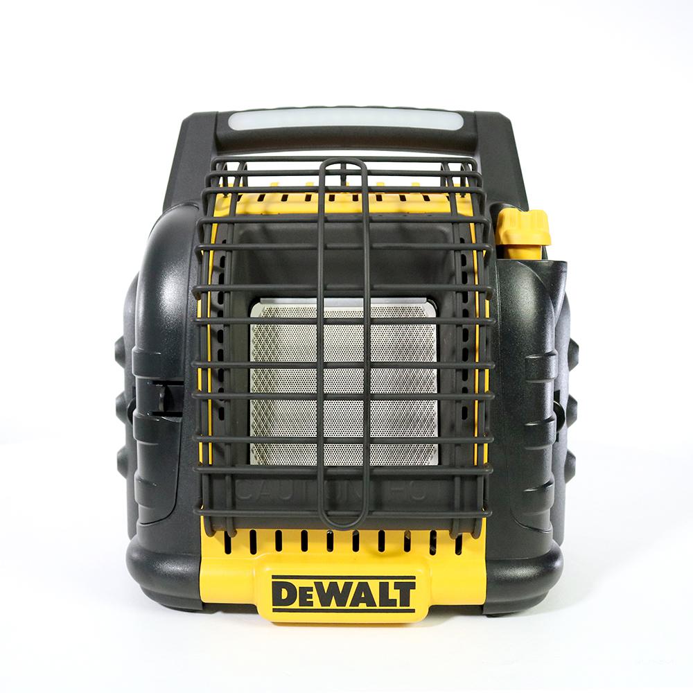

These are safe for indoor use and run on those 1lb propane bottles or you can hook it up to a larger bottle.
