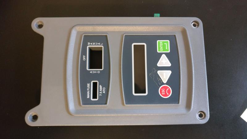

This post is a bit long but hang with me to the end. There is a point to be made.
Overview
As I’ve posted a few times, I have a Generac 20kw stand alone generator on our home. Recently, when I opted to do an oil change on the machine, I found the small keypad on the control panel didn’t want to function.
Without that input pad, you can’t access any of the data or capabilities in the controller. Not good. Since everything associated with this generator is expensive to fix, I began to worry I was on the hook for a big repair bill. Also, not good. With a little online searching, I found a new controller for the generator ran ~$400 with installation averaging around ~$200 (~$600 total). An additional downside to replacing the entire controller is that all the previous run and service data would be lost. I called two local generator guys who both told me they replace controllers fairly often, and that it was likely my only option to regain control of my generator. Not being content with that answer, I opted to explore further.
Troubleshooting

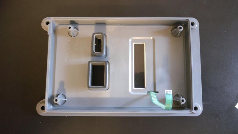

Since the generator was running its regular weekly exercise cycle, and I could cycle the unit on and off via the large main rocker switch, I began to suspect the problem wasn’t with the main computer board in the controller, but rather, might simply be a failure of a couple of the keys on the small keypad. Upon disassembly of the controller I found the front cover of the unit included the keypad, which was connected to the main computer board via a small ribbon cable.
Now I’m thinking maybe a $20 plastic replacement cover for the controller assembly might solve my problem. So back onto the phone I went to a couple local Generac resellers to see if I could order the part. The answer…Nope, Generac doesn’t sell that piece separately, I’d have to buy the entire controller (~$400+) to get it. That’s just stupid on steroids that a wear part, likely to break, and designed as a separate piece of the assembly, isn’t available for purchase. Annoyed but not deterred, I went back to the web and found a couple electrical company websites that specialize in generator sales and installs. After posting in their forums, a very nice guy in Idaho contacted me to let me know he had an old controller like mine, that was removed from a functioning system because the LCD screen got too dim to read. Since he was attempting to clean out his shop, he offered it to me for whatever the shipping cost would be to get it to me. I took him up on his offer and got his package yesterday. I disassembled his control panel assembly to remove the front cover, wiped it down a bit to clean it up (yes I am anal about cleanliness), and assembled it with my system control board and back panel. Then I reinstalled the control panel assembly back into the generator and powered everything up. And…….It worked flawlessly.
Summary
Ultimately, my hard headedness cost me a couple hours of time on the phone during the day and/or the computer at night to get to a solution. The control panel now works flawlessly, and because I didn’t replace the main system board in the controller, still contains all my run and service info. So what was my out of pocket cost? $11.20 USPS shipping cost.
So the moral of this story is simple. You can...
  • Pick up the phone and call a Generac service tech, schedule with him to be home when he does the repair, lose all your run time and maintenance info, and shell out ~$600. Or,
  • You can use that gray matter between your ears to learn a bit about how your generator works, perform the repair when it’s convenient for you, keep all your run time and service info intact, and save ~$589 in the process.
This is why I DIY.

Now you need to take apart the old cover and clean the contacts for those buttons so you can use it as a possible spare if you need to.
I already explored that option, but the keypad is molded into the cover making it inaccessible.
