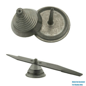

Georgeair
Ha! I think I still have one of those graduated balancer thingies in my rolling tool chest. Good thing they aren't made of steel since I've not used it in 11 years!!

Dremel and then had a balancer cone to insure I had evenly removed from both ends
Dad uses a bench grinder and balancer cone. His way is faster, but speed has a drawback as it's easier than Dremel to take off more metal than needed and have to replace blades sooner.
