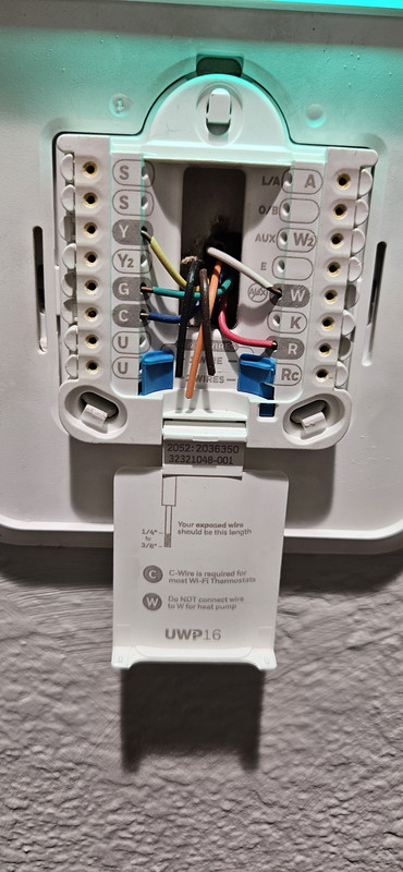

This is the wiring of the existing Honeywell
Posts: 18956 | Location: Spring, TX | Registered: July 11, 2011Reply With QuoteReport This Post
What’s the other end look like?
Posts: 15019 | Location: SWFL | Registered: October 10, 2007Reply With QuoteReport This Post

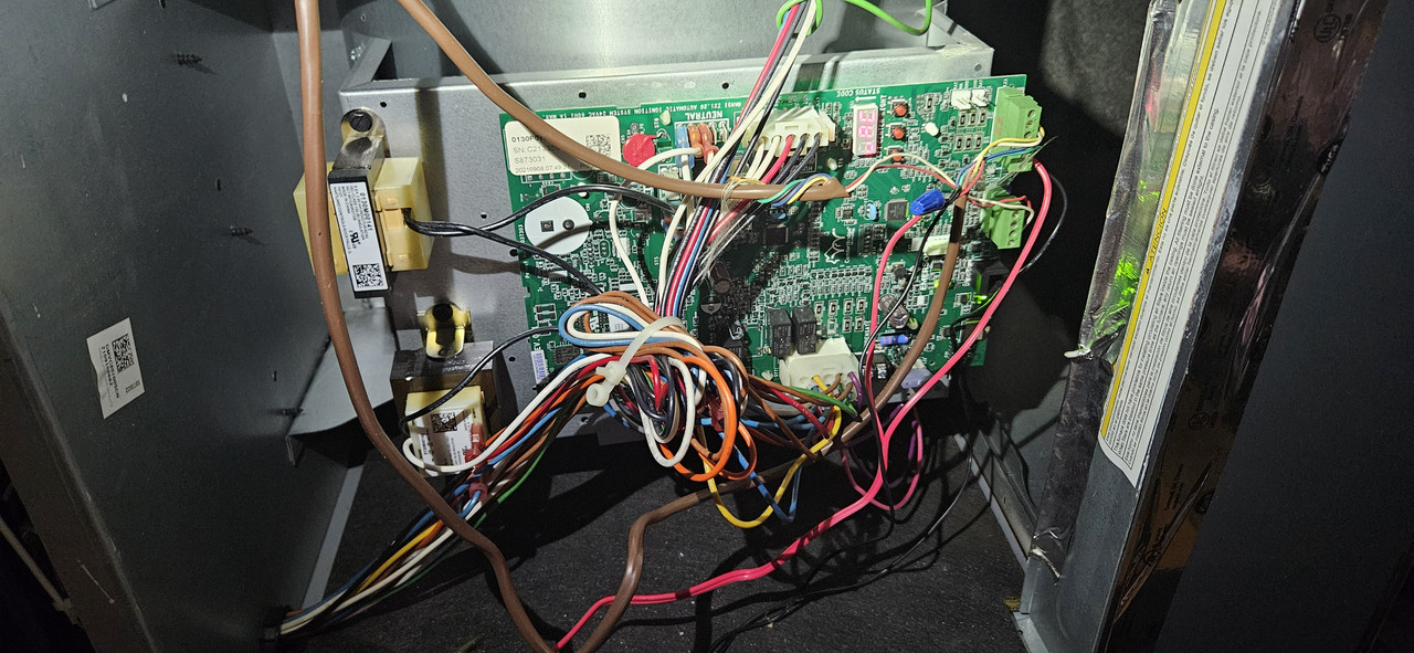

It will when he gets the right thermostat. I figured I’d move the process along by asking for a pic of the other end. Also, since the units are communicating, would he need a pic of the control board as well?

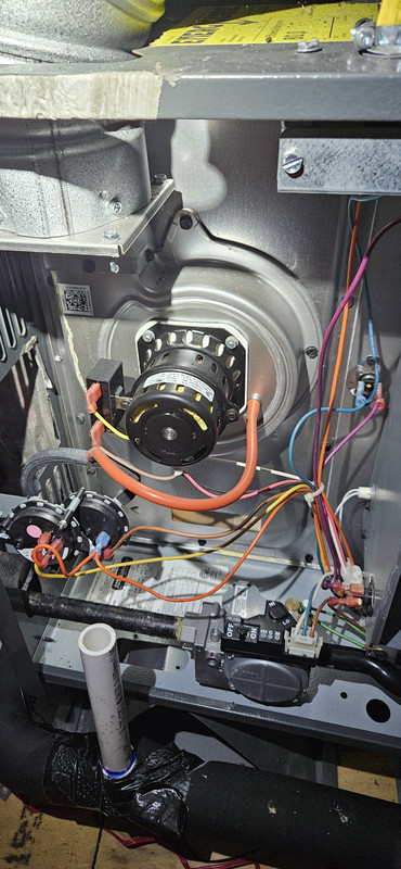

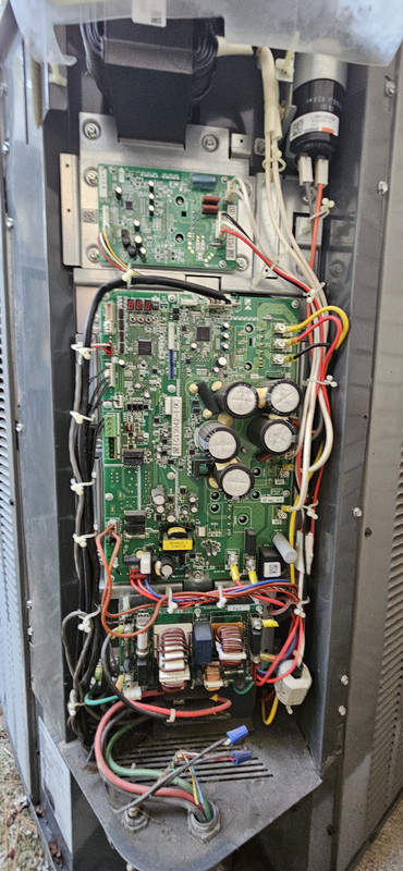

For those still playing along at home, here's some more photos.
Attic unit(s)
Outside condenser

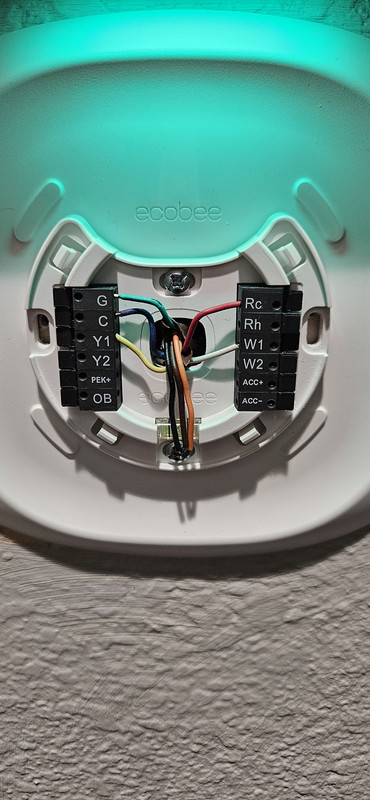

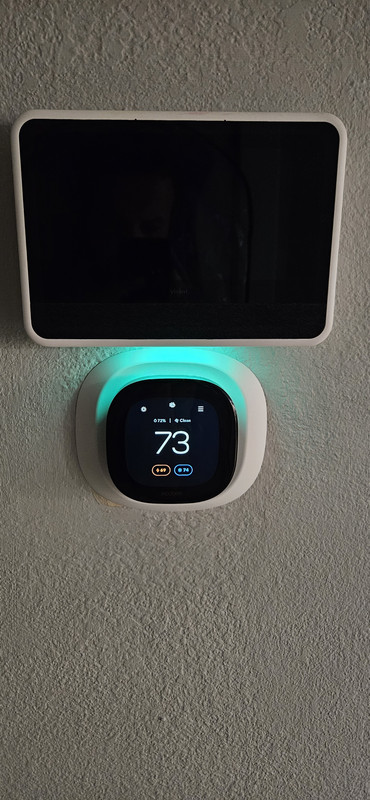

Went ahead & installed the EcoBee, with the same wiring setup the Honeywell had. Still have the orange, brown & black wires not connected.
Seems the thermostat does have speed control on the fan, I can hear it working at 2 speeds & it was part of the setup when configuring the t-stat. Not sure of how to check if the compressor is operating at 2-stage or not.
