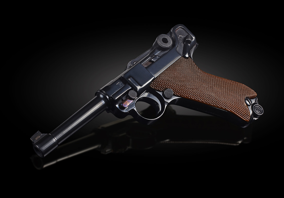

I think that weapons designers, like other disciplines, have some degree of arrogance when it comes to their finalized designs.
This can get them trouble.
Mr Borchardt, paging Hugo Borchardt…
But then, if it weren’t for his insistence that his design was just fine as is, we wouldn’t have gone from this:
To this (with the help of Georg Luger, brought in by DWM after Borchardt dug his heels in on a redesign):
I am kind of guessing though, Sig’s reluctance to change their design is… unlikely to result in anything as cool as the 1900 Luger!
