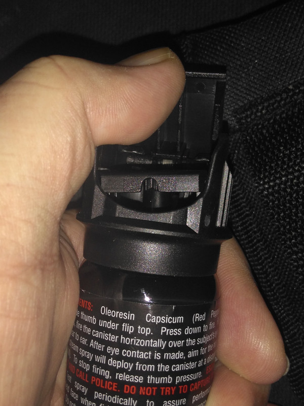

A few months ago I was given a couple new in box canisters of pepper gel, which I promptly threw in a gun gear storage box and dismissed, and instead decided to alter my defensive plans by adding an additional spare mag to my daily carry.
However, recent events have resulted in local ongoing protests, including some destruction and vandalism, and armed individuals attending. Ten minutes from my front door and for the tenth straight day.
Although I'm not happy about adding yet more gear/ weight to my carry gear, I'm now considering carrying the pepper gel, as one more defensive option.
I test carried the pepper gel over the weekend and found that the nylon pouch with the velcro flap tends to shift locations around quite a bit on my belt, making it a bit of guess work and fumbling around to try to reach. The pouch belt loop easily accommodates two inch belts, probably for use with LE duty belts, and I wear a 1.5" belt.
The thumb push button trigger is a bit lop-sided and with the soft pouch I'm a bit concerned about possibly shifting while seated, especially while twisting in and out of a car seat, and possibly having the pouch flap 'collapse' or bunch up, possibly allowing the protective spring-loaded flap to shift up and to allow an AD of the gel stream. I gotta believe that having a back or ass full of pepper gel, or clothing soaked in it, can't be a good thing in an enclosed environment like while driving a car.
I've read the manufacturer's instructions and watched a couple of their instruction videos.
-Anyone ever have pepper spray/ gel go off accidentally while wearing it?
-The canister sits pretty low and tight in the pouch, and isn't easily pulled from concealment clothing. Any tips as to which direction to orient the nozzle during carry or how the canister should sit in the pouch?
-Anything else I should consider when carrying pepper gel?
