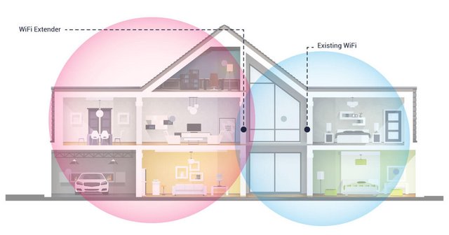

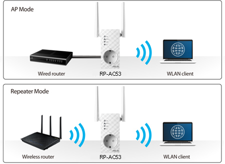

As far as the two technologies, here is a good illustration of the differences:
An access point is hard wired to your router via a cable (e.g. the Cat 6 direct buried cable I mentioned) and it's placed inside the OP's garage. In the garage, it'd communicate wirelessly with all of the devices (phones, computers, streaming devices, etc), but use the cable to communicate with the main router back in the house.
  • Strengths: There is a distance limit of communicating over Cat 6 cable but it's more than an order of magnitude greater than wireless. For the OP, the distance limit of a Cat 6 cable is a moot point because he stated the garage is only 25 to 30 feet away. Additionally, its signal doesn't need to "penetrate" the garage's concrete walls or metal roof because it's placed inside the garage. Generally (i.e. there are sometimes exceptions), the communication speed will be double that of the repeater/extender option.
  • Weaknesses: The OP would have to physically install a direct burial cat 6 cable from the basement to the garage.
    A repeater/extender has to be placed in a location with good wifi and it extends the wifi to the desired location (e.g. the OP's garage). Think of the main wireless router having a circle around it and the repeater extender having a circle around it. Here is a good illustration of repeater/extender placement:
  • Strengths: easy set-up if location, distance, and "penetration" work
  • Weaknesses: The repeater has to be placed within the main wireless router's circle and it's extending the circle has to reach desired points in the garage. The OP's garage has to be BOTH within the circle and the wifi signal "penetrate" at sufficient strength. Generally (i.e. there are sometimes exceptions), the communication speed between the main wireless router in the basement and the repeater/extnder will be half that of the access point option.
    Several people have mentioned mesh. There are two types of mesh:
  • Wireless backhaul. It'll have the same strengths and weaknesses as the repeater/extender above. In other words, it won't work if you can't physically place the somewhere beneficial AND can't "penetrate" at sufficient strength. If it physically works, it's even easier to set-up that a repeater/extender and even easier to use.
  • Wired backhaul. It'll have the same strengths and weaknesses as the access point above, but be easier to set-up and use. My new mesh system is wired backhaul, and it takes much less tech savvy than my old wireless router and wired access point that I had essentially made into a homemade mesh system.
