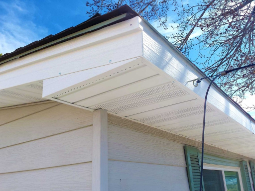

First let's make certain we've got our terms right. A soffit is where the roof extends beyond the walls, creating an overhang. Like this:
Both soffit vents and either cans or ridge/hip vents are absolutely necessary to ensure adequate airflow through the attic space. In fact: The amount of soffit vents and roof vents (whether cans or ridge/hip) are supposed to be balanced.
