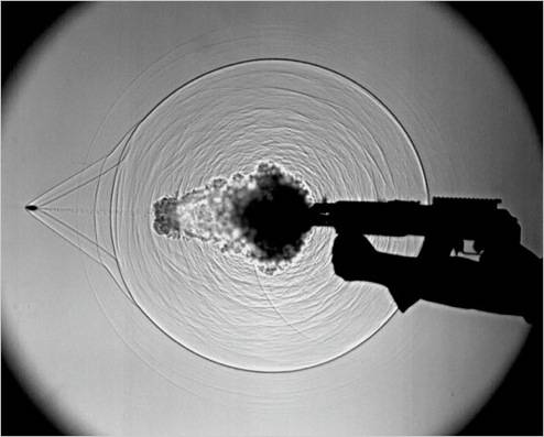

Here is an interesting discussion on a physics forum, if you have the time and interest to read it. There is some disagreement and heated tempers Smile.
Here's a picture and an excerpt:
"I don't think that you hear the sonic boom of a bullet that you have fired yourself.
When the round shockwave reaches your ears, you hear the "bang" from the shot. The conical shockwave behind the bullet that causes the sonic boom never passes your ears. They are inside the geometrically extended cone from the start (or behind the cone if you will). So the expanding cone surface (sonic boom shockwave) never passes them. "
Reference https://www.physicsforums.com/...boom-why-not.531823/

As the bullet accelerates to the point at which the shock wave forms, the acoustic energy radiates outward just like any other acoustic energy (at the speed of sound). So you definitely "hear it"
It only appears that you are "inside the cone" because you are looking at the steady state condition set up after the bullet has travelled for a ways and the shock wave has formed a characteristic wake angle. It has already past your ears by that time.
Suppressors work by diffusing the pressure wave at the muzzle, so they are reducing both the shock wave in front of the bullet, and also the blast pressure behind the bullet. They would be separated by only the time it takes for sound to travel the length of the bullet, so indistinguishable from a practical viewpoint.
Yes, the sonic boom can be reflected and even amplified by those reflections, depending upon exactly how the reflected surfaces are arranged.
As already pointed out, "auditory exclusion" is a perceptual phenomenon. The damage is done, you just don't know it until later.
