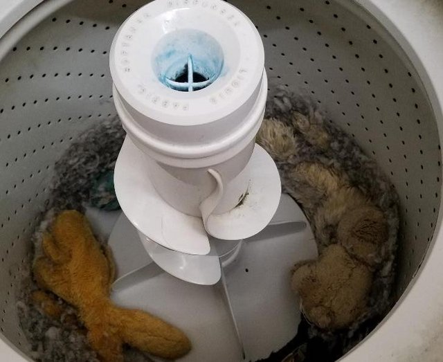

Earlier this afternoon, I knew I was going to have to put a question on SF: "how do you clean the inside of your washing machine?" I expected all sorts of fun answers including, "you don't -- it's inherently clean because it's a washing machine."
But it's a little different today. Today is "wash the dog's stuff day." That always leads to a giant wad of dog hair in the basket, and a fun exercise in gathering stray hairs from the nooks and crannies.
My dog is old. She's near the end of her string, and there's no denying it. Might as well reserve her space now in that field at the Rainbow Bridge. Miss Boogerhead (aka Molly, aka Dorkhound) soldiers on, though. She can't hear. I always thought she just ignores me, but now it's for real. I can walk right up to her and she's got no idea I'm there until I touch her. She can't see. We hang out in the garage in the evenings and it's like doggie pinball, watching her bounce off the car, the truck, and whatever else is in her path. She has a hard time getting up in the mornings (heck, so do I!), and I often have to get myself halfway into her crate so as to lift her up from her sleeping position.
But she shows me no sign that she's in pain. Maybe that's for real, maybe her prescription drugs are doing their jobs. So I can't yet take her on that last ride to the vet. Something else she can't do well, however, is "take care of business" before bedtime. It's not unusual lately that I'm cleaning a deuce out of her bed while she's wolfing down breakfast. Most of the time, though, she manages not to mess the blankets. Last night was different. She had some kind of nuclear meltdown overnight. Great golly, it was nasty.
So after I finished doing my own laundry, I [somewhat reluctantly] gathered up some of hers. I figured I'd wash the stuffed toys first. One of her bears had suffered the brunt of the meltdown; the others were more fortunate but they could use a trip through the washer too. I set up a good hot wash, poured in some bleach, dumped the stuffed critters into the washer, and went on about watching football and preparing dinner.
After dinner I figured I'd get the critters out and start the clean-the-washer routine.
Great Caesar's ghost! Eek What a mess!
I didn't think about the bear whose "belly seam" had split. It's like there's been a stuffed animal massacre in there! Hair, bears, "stuffins," hides, ... oh, my word!
It may not be a crappy mess now, but it's certainly a mess!
Wow, it's going to take a week to clean this mess up. I should have just gotten her some new toys! Big Grin
