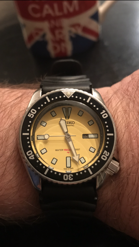

I found it on eBay for like $9 with free shipping. I’m wondering if it might have other issues as it runs pretty darn fast. It’ll be fun to try to get it running better.

Going through the earth's magnetic field does it. Navy ships and submarines regularly get demagnetized otherwise they get detected more easily.
Trapper189, have you ever checked them? It’s weird, I have two watches I thought were a little fast but fine that both read slightly magnetized. I am wondering how that happened. The app on my phone seems to be working well enough at detecting magnetism, I checked it using a few different magnets.

Your phone has magnets in it. Absolutely keep your watch away from anything with a speaker/coil in it.

Mars_Attacks, dude you were right! Cool I bought a demagnetizer on eBay, watched a YouTube video on the process and that was in fact the issue. My tiny diver is now keeping great time and will be getting a lot of use. Thanks!!!!
I’m glad I bought this demagnetizer. My son has an Invicta 300m diver that was running consistently around one to two minutes fast in 24 hours. Out of curiosity I checked it and did detect magnetism. After demagnetizing yesterday his watch appears to be running considerably less fast. I haven’t had a chance to really look at its performance too closely yet but it appears to be more accurate.
