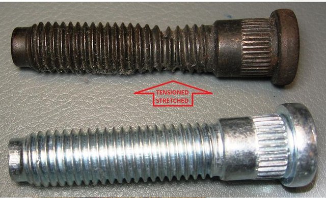

With my current old car project, refurbishing a 21 year old Camry (low miles, great paint), I notice that not all of the tire lug nuts torque the same. A few of them are "off" in the way feel when I torque them down. Most of them are like any other wheel mounting job using a hand torque wrench, they all torque down nice and evenly over two or three passes until the final pass for the remaining 40 ft lbs using a torque wrench. But on this nice old Camry, some of them are not torquing down normally. A few of them feel squishy for lack of a better term. Almost like they may have been stretched in the past past their elastic limit by some wrench monkey with a air wrench while in the hands of the previous owner. The torque on these small cars are only 65 ft lbs, and I'm guessing some tire mounting gorilla hit them with his air wrech at 150 ftp lbs, or more likely 250 or 300 ft lbs or something crazy like that. When I removed them the first time, a few of them were obviously too tight, but nothing that peaked my suspicion, since I didn't have to really work it or stand on it etc., but some had been overtightened for sure.
Have you guys delt with this before, and does that sound like it my be my situation ? I know wheel studs are not really expensive and more or less easy to replace, but I'm hesitant to replace only a few, instead of all, but especially when I'm not sure if this is the problem, or not a problem. I know bad bolts are important because it's the clamping force resulting from the designed elasticity of the bolt itself that imparts the clamping force of the wheel to the hub that is responsible for attaching the wheel to the vehicle.
So do any of you guys know how to diagnose a ruined wheel stud bolt that has exceeded its elastic limit, even though the car is running normally ? Any way to more or less diagnose it without removing the stud from the hub and testing it somehow ?

I would not be too concerned with it as long as the lug nut moves freely on the stud, if it was stretched the nut would bind up. You could measure the length of the studs from the hub face to see if any are longer.

The stretched studs will be a little longer than the un-stretched.
If you can measure the length you'll find the bad ones.

Spin them on by hand with the wheel off too. If they are stretched the threads will be farther apart and you should be able to feel that.

If a wheel stud bolt has exceeded its elastic limit it will change the thread pitch in a spot somewhere on the threads. Get a new lug nut and screw it on by hand without the wheel. If the stud has been compromised your fingers will tell you by the feel

Wow, a great test. Thanks !
