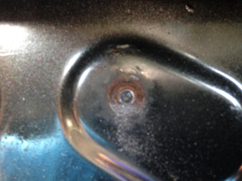

I have a 4Runner with a snapped off bolt where the license plate screws into the back of the vehicle.
I drilled a hole, as close to center as possible but I can't get the #2 extractor to bite.
I'm thinking that maybe I need one that is more tapered than the cheap one I bought?
It's pretty rusted in there. Who makes a good one?

chellim1
Once a screw extractor breaks off in a drilled bolt, your problems are worse than when you started.
That's what I'm worried about.
I drilled the hole (using a left hand bit, in reverse) pretty close to center, and it's about 1/4 inch deep.
Not a great photo, but here's what we're looking at:

You need to address the reason the screw became stuck in the first place. Rust. Use liberal amounts of penetrating oil such as PB Blaster to pretreat for a couple of days. Otherwise you have little hope of backing the screw out.

That looks like it might respond to a combination of penetrating oil followed by drilling all the way through the bolt with a small bit and then increasing the bit size until you've hit the largest size possible without damaging the threads.

If the hole you drilled is close to center, I'd use the correct size drill, all the way through, to tap it over again. Either the remnants will come out or you'll have good enough threads for a license plate.
