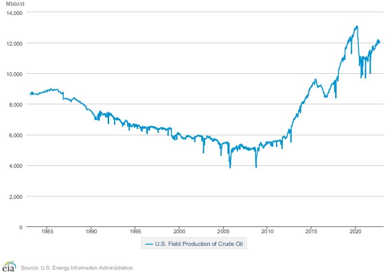

Originally posted by Russ59:
A question for tatortodd and other O&G guys, particularly on the upstream production side of the equation.
All things being ideal, just how much more oil could the US squeeze out of the ground, say in the next 12-36 months? Let's assume $60-90/barrel prices, rig availability, pipeline capacity in place, federal and state permitting is optimized, and access to capital is also ideal.
Current levels are 11.6M to 12.0M BOPD, even with Sleepy Joe in office.
I'm curious with OPEC+ announcing a 2M cutback (world production appears to be around 80M barrels oil/day), could the US get to 14-16M BOPD?
I wish to remain employed so I'll only post from publicly available sources (e.g EIA).
A picture tells a thousand words and the pictured graph speaks volumes about US domestic production not being where we were before COVID:
We've been at 13.0M so that's achievable. EIA's short-term energy outlook (STEO) thru 2023 will next be published next week, and the longer term EIA report is from prior to Russia invading Ukraine (i.e. not worth reading and next one is Feb '23). However, STEO from a month ago is forecasting:
  • about 1.0M BOED increase in domestic production by year end 2023. In other words, it matches my statement that returning to pre-COVID domestic production capability is likely in the near-term.
  • roughly 1.0M BOED increase in domestic refining by year end 2023.
    Industry news and local Houston news is full of stories about Gulf Coast refineries are building / have built more capacity to refine West Texas and New Mexico crude oil. Pipelines have been built to get West Texas and New Mexico crude oil to the refineries.
    When looking at refining capacity on EIA's site in same time period as domestic oil production graph, I see:
  • 2.2M BOED increase despite the dozens and dozens of refinery closures. In other words, significant expansion within existing fenceline. The problem with no new refineries and 0 refineries between florida and Deleware is local shortages from natural and manmade disasters.
  • Refining capacity is down from PreCOVID levels. Too tired to grab a link, but I've read many industry news stories this year about many planned turnarounds were deferred due to workforce challenges during COVID and as a result there are numerous 2022 turnarounds.
