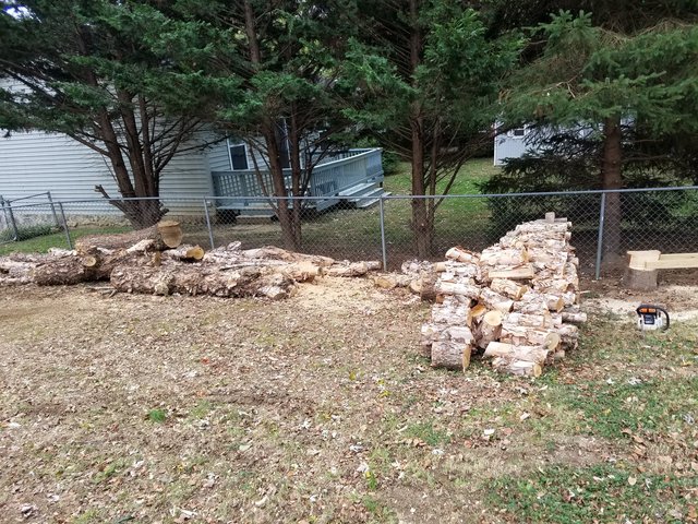

ETA: pictures, so y'all don't think I'm slacking. Big Grin
There's still plenty to do. I guess my next learning session has to do with chain sharpening.
Posts: 16532 | Location: VA | Registered: July 15, 2007Reply With QuoteReport This Post
Nice haul!
