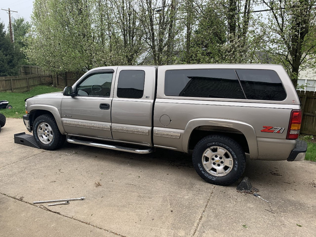

The rust battle continues but we’re almost to the end.
So far all brake lines, fuel lines, rockers, and cab corners have all been done.
Next on the list is the frame, lower control arms and rear end. I plan to use POR15 or Eastwood. My reading says a topcoat is a must for parts fully exposed to UV rays as it dulls the finish. I do not believe it has any ill effects on the protection.
I don’t want a super slick shiny frame and rear end any way so if the semi-gloss sheen fades a little my feelings won’t be hurt but being under the truck won’t get much UV.
Will be replacing upper control arms, sway bar endlinks, inner, and outer tire rods and she be pretty much good as new.
Have a plastic bed liner so that will likely go by the wayside for Line X.
Just put some wheels from a 2010 on her with some new rubber. Camper top is gone for a roll up tonneau.
Not bad for 20 years old.
