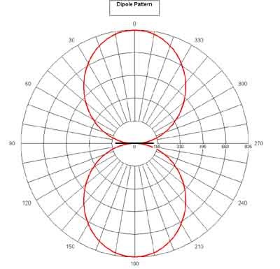

You don't get something for nothing in antennas. Antennas achieve gain by being directional.
A simple dipole antenna, which is just two radiators on the same axis, has its main lobes at 90°, front and back, at right angles to the axis of the elements.
Like this:

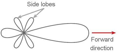

When you create a yagi (my photo, above, is of a yagi antenna with a corner reflector for the UHF elements), you start extending and narrowing the lobes on the axis of the boom, shrinking the back lobe, and creating little side lobes at various degrees to the sides.
Something like this:
So, whether a more omni-directional antenna would work for you or not one cannot say without seeing your TV Fool report.

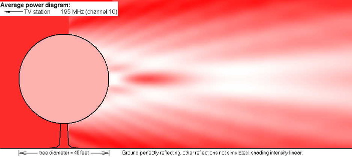

Found an excellent image illustrating RF diffraction due to a tree.
