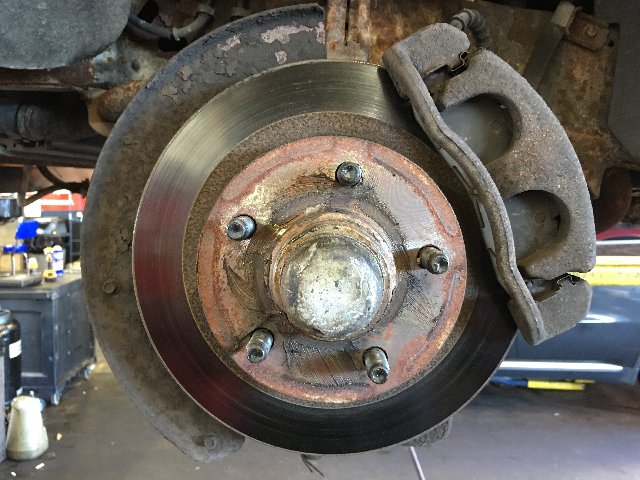

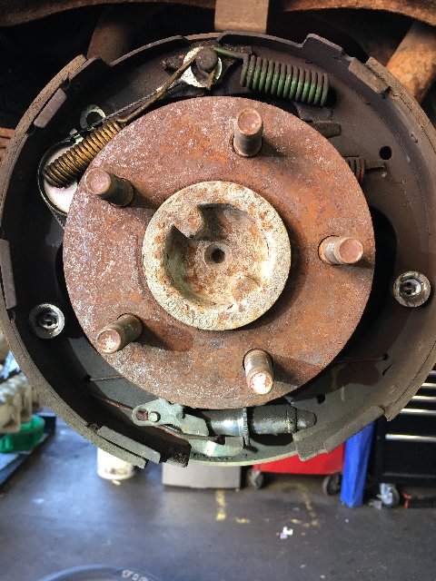

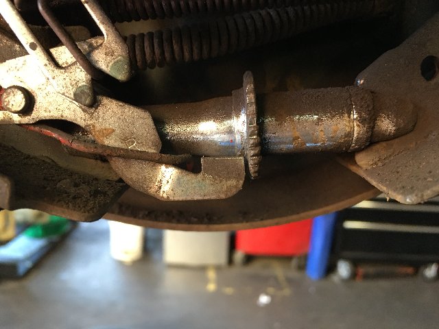

Tell me, what looks wrong...
Well first off the rotors were tiny. In fact if you take a good look at the 2nd pic, the brake pads were being cut in half because the pad overlaps the outer edge of the rotor.
For the rear drums, Calverts used the wrong hardware kit. As you can see the adjuster is not even close.
In essence my daughter was driving a truck with only 50% braking ability on the front and 0% on the rear as the rears were never properly adjusted on either side.

From your original description of the work done 30,000 miles ago, I don't see any mention of the front rotors being replaced by them.
Something doesn't look right the way the pads are wearing and the rear adjuster isn't right either but I don't see catastrophic brake failure there except for the brake line.
The rear shoes have worn very evenly so it doesn't look like the adjuster caused a problem in spite of the issue there.
The car appears to have been operated in an environment where the salt has made everything corrode. You didn't mention how long ago they did the earlier work but a brake line failure in that old of a vehicle in that condition isn't that unusual.
Posts: 10730 | Location: NE GA | Registered: August 22, 2002Reply With QuoteReport This Post

I think you know this, the brake line had nothing to do with the poor work performed earlier.
That was tearbile work done 30K ago. Wrong rotors installed. And rear adjuster was installed backwards, that's why the hardware didn't engage the wheel. I would say the pictures are worth a thousand words. I would contact the shop manager. This is a shop that pays minimum wage? I would bet my money on that. You usually get what you pay for, that wasn't even a good part's replace monkey, much less a mechanic. Sound like you found a good mechanic to fix it, although I worry that you underpaid him.
It looks like the right part, but is in backwards. The threaded part - not visible behind the lever - should be facing the front. If it were turned around, the teeth on the wheel appear to be facing the right direction to be engaged by the lever. (It is possible to switch sides, which would result in the brakes continually un-adjusting themselves.) Regardless, the result - a non-functioning self adjuster, and very probably a grossly out of adjustment brake - is the same.
