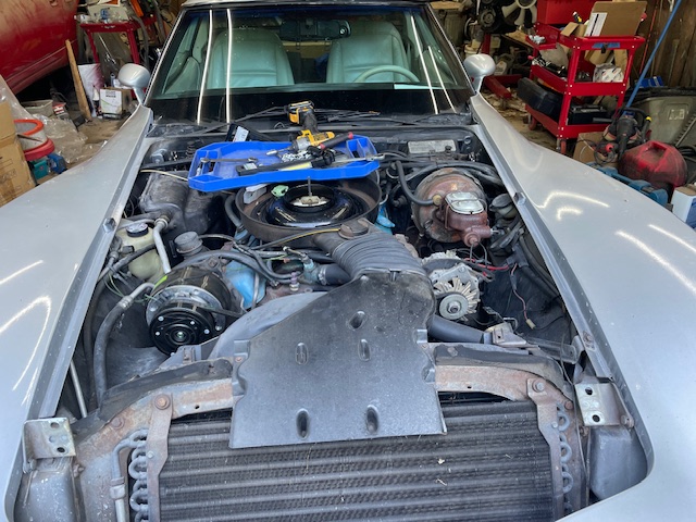

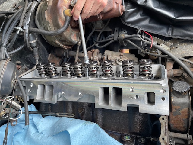

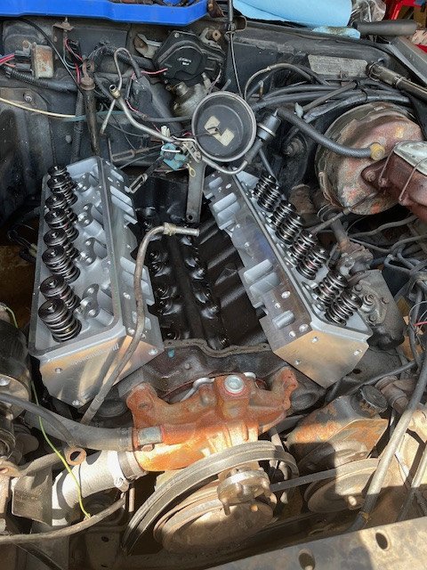

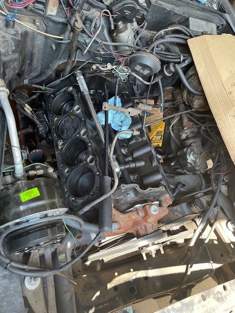

Test fitting the heads. The alignment pins must be clean.

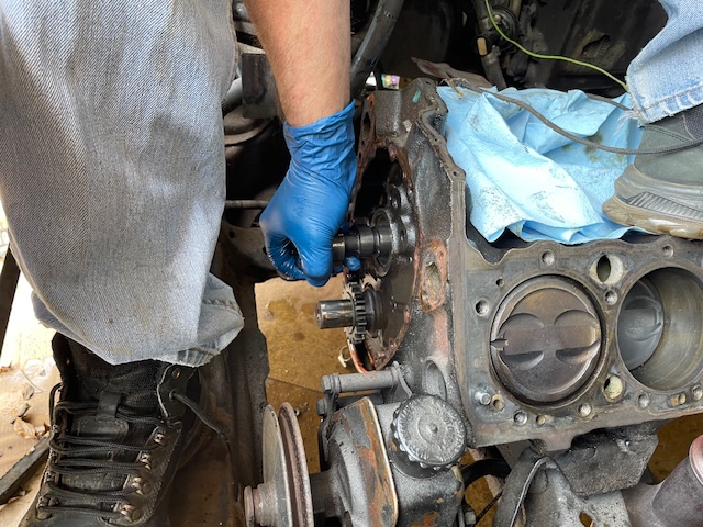

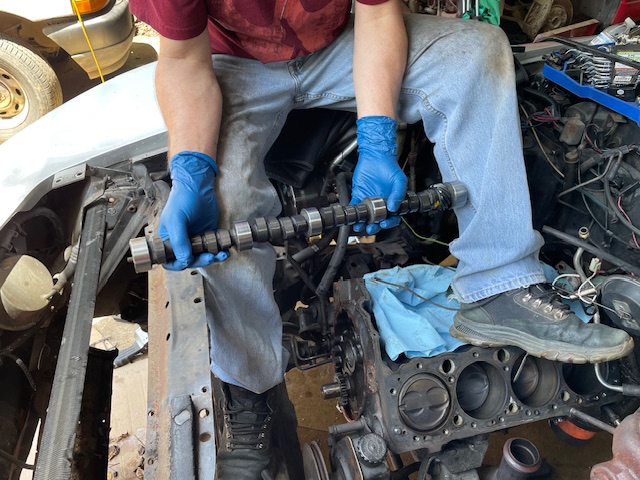

Ooooo! A new bump stick! (camshaft)

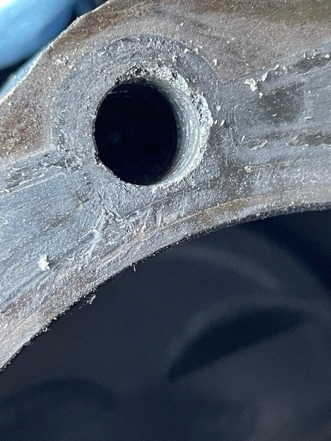

Well everything was going great until one bolt went loose at 30 pounds...
So now it's drill the block, tap it and screw in an insert. Ugh.

The other head torqued right down. We ordered a thread insert kit and will be repairing the block.
It was a setback, but it's just too hot to go do car shows.
The engine was defectively drilled from the factory and the threads were damaged upon head bolt removal. We didn't discover this until we inspected the old head bolt.

Were you able to get roller lifters and rockers? Looks like some big ol' ports on those heads.

1.6 roller rockers. Flat tappet on the cam.(a mild cam at that, I want torque not RPM).
I'm not doing headers as it would require a complete new exhaust.
The original rams horns actually work well.
I'm not going to turn up enough rpm for scavenging.
Removing the old smog heads and intake will actually increase fuel economy and almost double the horsepower.

Interesting 'footwork' there...Never seen that done on an engine we working on/intended to run afterwards! As a rule, I prefer to keep the internal areas/machined surfaces of the engine pretty much sterile during 'racecraft' activities. Razz
Purpose-built race cars have the luxury of easy access to the engine. Even with the hood (which is front-hinged) off, it's a looong reach over the nose or fenders of a "C3" Corvette to the front or top of the engine.
AND the nose was two feet off the ground to access the underside for access to the fuel pump, radiator mounts and manifolds.
Made it very difficult to put the cam in without climbing into the engine bay. I ensured the cylinder bores were clean before buttoning it up.
The engine hoist and stand are already in use as observed by the 300Z engine in the background........ Well, it had to be observed first.
We have three cars in progress at the moment, plus everyone comes over on the weekends to work, leaving resources spread pretty thin.

2101 intake, so the stock Quadrajet 700 cfm and air breather fits.
I want it to look stock. It'll make about 325Hp.
I had to go with 1.6 rockers. Because of the rocker studs.

That bad bolt hole is a drag.
Minor inconvenience.

What heads and cam did you choose?
Heads: Speedmaster III 190CC runners, big valves, 1.6 roller rockers.
Cam Summit 1102- Duration at 050 inch Lift: 204 int./214 exh.
Advertised Duration: 278 int./288 exh.
Valve Lift with Factory Rocker Arm Ratio:0.421 int./0.444 exh.
Lobe Separation (degrees):112
Edelbrock 2101 intake
