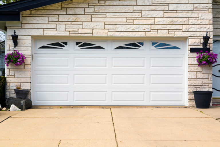

Roll-up type, non-insulated. As to fitting inside one panel- I haven't measured, but it would have to.
Posts: 115155 | Registered: January 20, 2000Reply With QuoteReport This Post
The most common pet doors have an inside and outside piece and fit a door 1 & 1/4" to 2 " thick.
The outside is mostly a trim piece, and the inside piece is where the plastic flap attaches.
If there is a clear flat space for the size you need then you could build a wooden frame to fill in for the thickness needed.

Since the metal in the door pictured is rather thin, I would built wooden “picture frames” to go on both sides and screw them together. Then mount the dog door to the frame.
I'd use PVC "wood" to eliminate rotting issues.

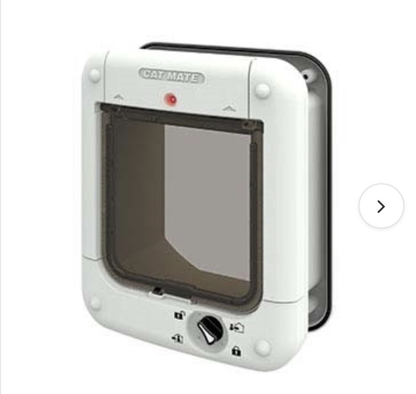

From the company the Monkey referenced, this one is electronic and uses the cat’s internal chip, if he’s been chipped, for $111:
https://moorepet.com/cat-mate-microchip-cat-flap-360/
It’s only $18 more if you need a chip to hang on a collar.
If I’m reading it correctly it will work on a thin metal door with no adapters.
