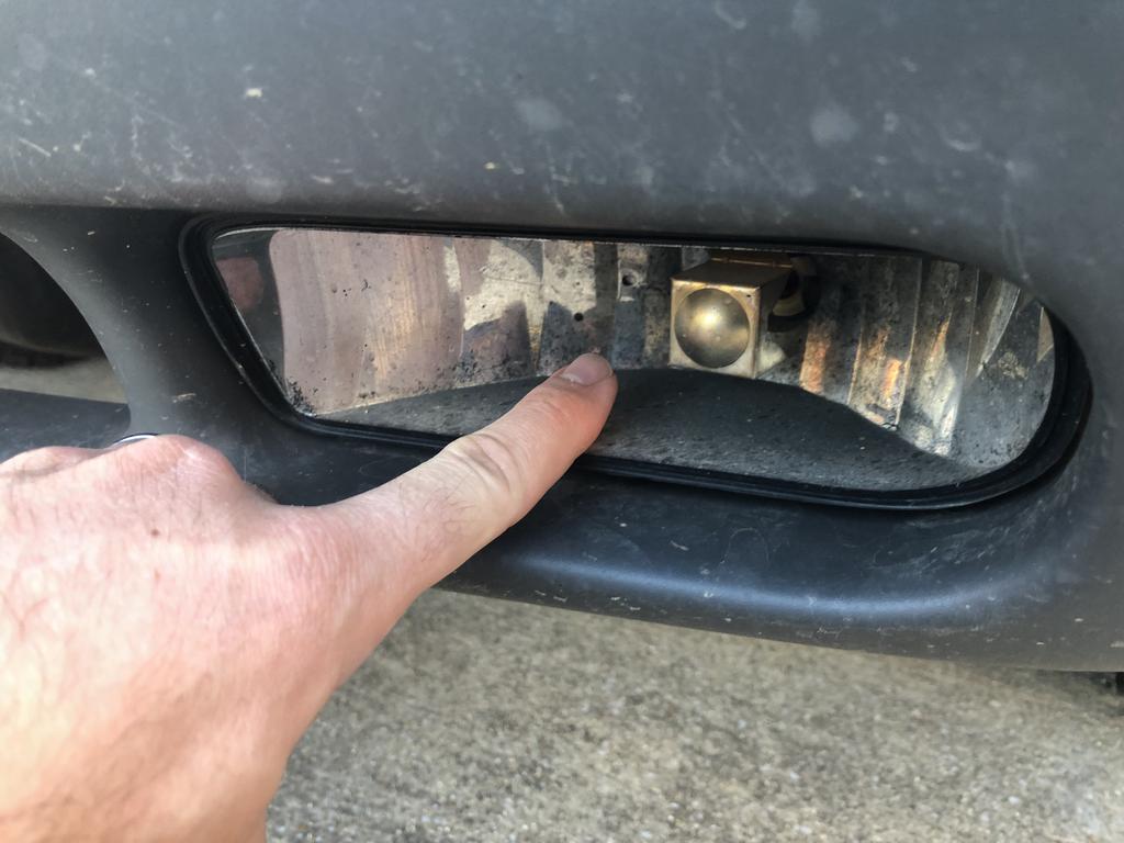

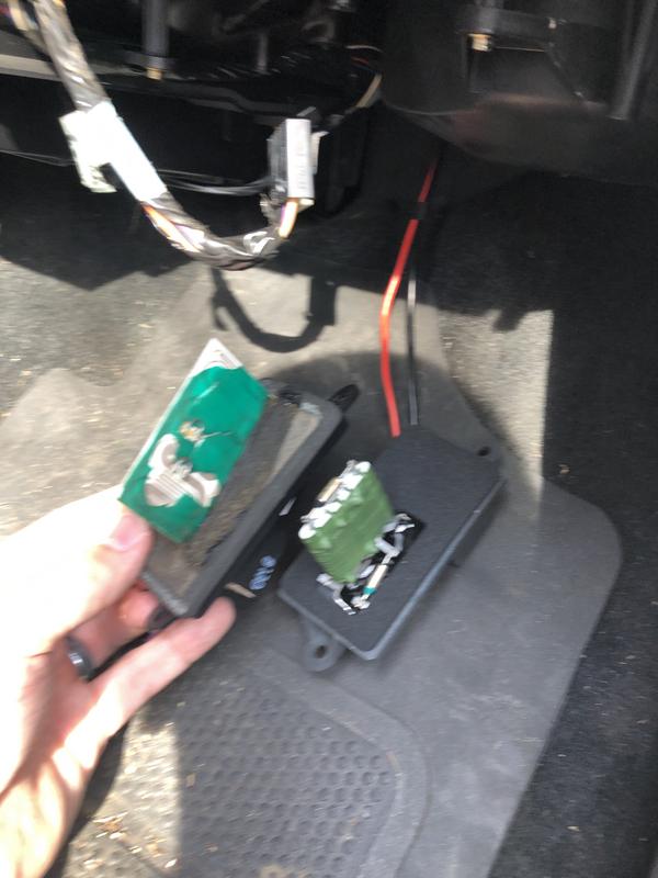

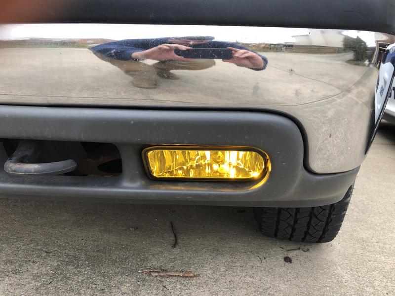

New fog lights, cabin air filters, and a new blower motor resistor, also drilled a couple tiny holes in the rear of the signal housing as it was holding moisture. Did this with my Explorer and never had any moisture after that. Hopefully the outcome will be the same and not need to replace them.
I am a maintenance freak and do all the scheduled maintenance at half the intervals that the factory suggests. Yet I have never in my 20 years of working on cars changed a cabin filter. Not sure why just never really thought about them. Was having some issues on low with the blower (hence the new resistor) but one video I saw swapped the cabin filters to help flow. So figured I would do it. Boy was it nasty up there. This was my grandfathers truck before I got it. The cabin filter had been changed as one of the screws holding the cover in was missing but still nasty.

Best of luck with the fog lights, seems to be super common on Silverados & Tahoes for those to be broken.
