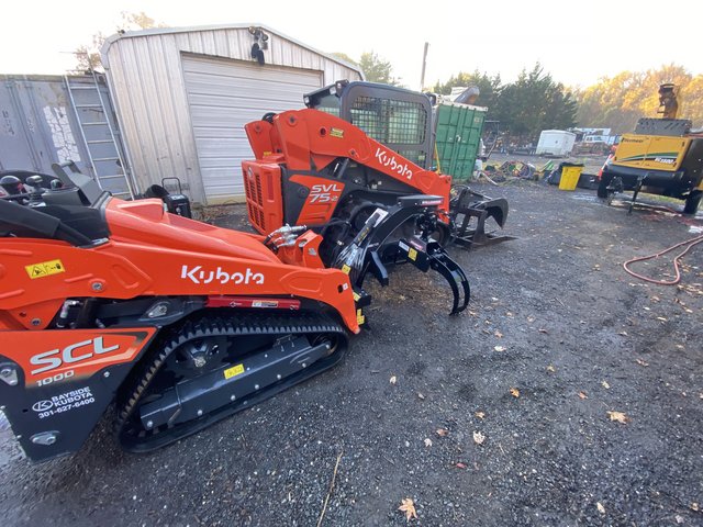

I own a Kubota SVL 75-2. I use it for moving logs, piling wood chips, and cutting fields of brush and small trees with a 72 inch rotary brush cutter. I have not had any problems with it. The hydraulic system gets a few complaints from people because it it a little sluggish when turning. The new SVL 75-3 solves that problem with a new system that is more efficient at splitting power between the boom and tracks. The SVL 65-2 has this newer system and can do almost as much work as the SVL 75-2.
The overhead door is a huge benefit. If you have to communicate with someone while performing a task, the open door makes it easy. As BRL mentioned, with a conventional door, if the boom is raised even a few inches, the door is blocked. Several times, I have had to open the door and climb over the bucket or attachment. In one instance, I was travelling through a wooded lot and buried the front of the machine in a hidden bog. The loader was stuck in a nose down position and it was impossible to lower the boom. I would not have been able to open a conventional door. I also own a wheeled skid steer with a swing out door and have been stuck in it when the motor died and the boom was up. Takeuchi also makes a compact track loader with an overhead door. A friend owns both Takeuchi and Kubota loaders and he prefers the Takeuchi. They cost more, though.
If I had to replace my SVL 75-2, I would buy an SVL 65-2 because it is lighter and can lift almost as much weight. I would have no problem buying an SVL 75-2 again or the new SVL 75-3. I think they are the best value. Other machines are a lot more expensive. Plus, Kubota offers 0% financing.
