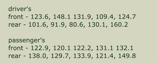

With 118,000 miles on our 2012 Odyssey EX-L, I will 3rd the lugnut torque. Get yourself a breaker, 22mm deep socket, and a good torque wrench. Anytime anyone else takes the wheels off and puts them back on, lossen each lugnut a bit with the breaker and then retorque them in a star pattern starting with 70ftlbs, and star pattern again at 94 ftlbs. Check them again after 50 miles. It really is that important.
I watched the guys at Sam’s Club miss torquing one of my lugnuts. The first guy did four out of five. The second guy some managed to check the same four out of five. Both denied it. I went out and bought a digital torque adapter that will measure peak torque when loosening nuts and found the following:
That being said, I did replace the rotors at about 20,000 miles. I don't remember what I used for rotors or pads (probably RayBestos Element 3), but I bedded them myself and haven't had a problem since. This includes 9,000 miles of towing two PWCs on a tandem PWC trailer. I'm sure I've replaced the pads at least once, but I haven't touched the rotors. I used ceramic pads as they don't eat rotors, but they have enough stopping power to activate the antisocial brakes on dry pavement.
