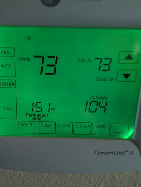

Not sure where you are getting that you can only have a 15 degree difference between outside and inside?
My Lennox system can easily make the house 68 if I want with it being 100 outside. We’ve had a couple of 100 degree days. I choose to keep mine at 72.
