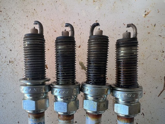

I’ve tried searching on the internet for a simple explanation to no avail so I ask you:
What story do my old plugs tell?
They came from a 2015 Subaru Outback, 2.5 liter, with 95k miles.

Seems like an awfully large gap to me.

Check your owners manual, I believe Subaru spark plugs call for 60K mile replacement, if those went to 90k miles, they're fine.

The one on the right is saying “Why is there oil in here?”
Are Subaru 2.5s known fir valve guide issues?
The other three are singing “Three of these things belong together, one these things just isn’t the same…”

They are saying "Change me!"

They look burned, that is NOT a 1.1mm gap.

I haven’t changed plugs for quite a while now, but I changed a lot growing up as a hot rodder and later as a DIYer. Many things have changed, and the biggest is ignitions.
We eventually switched to electronic ignition after a while, and I remember our plugs looked different after a similar amount of time.
We used to jet our Holley carbs so our plugs had a level of copper color. Now with the latest and greatest electronic ignitions and injection systems, i don’t know.
But the basics were, the darker they were the more rich it was running. The lighter, lean.

As cheap as plugs and wires are I usually change 40-50k miles. As far as the oil on plugs, check and replace your spark plug tube seals. I'm more familiar with Subaru EJ engines than your engine though.
Replace the wires too. I've worked on EJ engines that were still running with broken wires (usually break right at the plug) and it's a cheap and easy replacement.

Looks like they have been in too long for the most part, #2 and #4 do look a bit like some oil may be getting into the combustion chamber, likely a valve seal, does it smoke a bit at start up after sitting overnight?

I believe those are old Splitfires. Not sure if they are still made.
That was my fault. I made an "assumption" they would be due at 100k and not 60k. Imagine my surprise when I realized I was overdue by 35k.
Incredibly, the plugs come pre-gapped and the new ones were very similar.

No smoke...so far.

They say that your rings are good and you have been using fuel with detergent based additives.
The gap for platinum plugs looks fine and you'll need some anti-seize.

Left to right: Good, Good, Lean, Rich and/or debris.

What does the overall oil consumption look like?

How was she running? NOx? Looks like they did their jobs. Far right #4?
Always gap your plugs, never trust them out of the box.
Somethings going on with #4 (far right). It looks like something has coated the plug.
