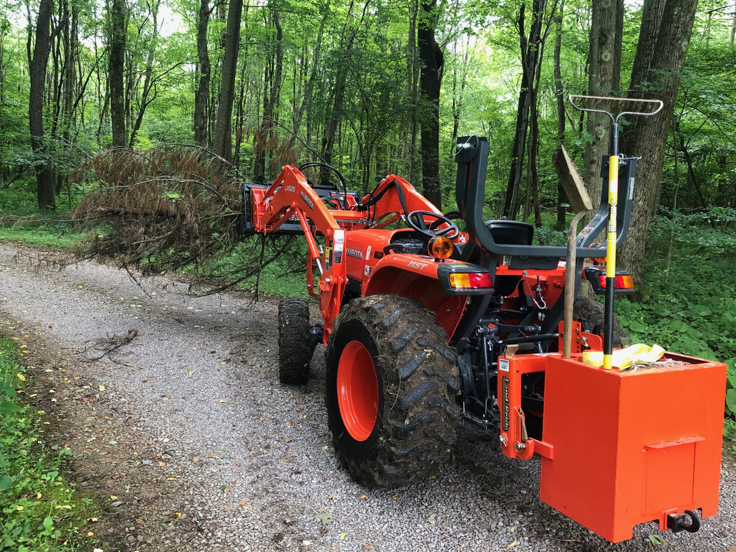

Looking to make life easier when switching implements on my Kabota L3301. Dealer wants about $500 for their quick hitch. Pat's is under $200 which includes tax and free shipping from Rural King.
Pats QH
My rig:
Thanks
Mike
Pats QH
My rig:
Mike

Been awhile since I used Imgur and took 3 attempts to get it right!
Mike
