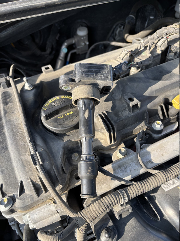

That's a cylinder 1 misfire. According to Google, that's the one closest to the passenger side on that vehicle. I'd start by popping that coil off and seeing what it looks like in there.

It looks dusty, but I see no damage and no sign of oil either.
Posts: 306 | Registered: September 13, 2008Reply With QuoteReport This Post
Well that's good. If you have the ability to read codes, you could swap the 1 and 2 coils and see if the misfire changes cylinders...might only need to buy one coil and swap that out if the misfire follows it. Could save you some time and money, but depending on the mileage it might not hurt to just change everything as a preventative measure anyway if you can afford it.

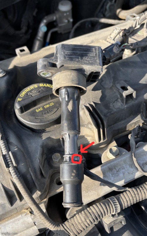

It may be nothing, but something looks suspicious.
The little white spot may be a burn-through. If this has happened, your spark, taking the path of least resistance, will jump through it and arc to the metal spark plug tube. Take a screwdriver or similar object with an insulated handle, fasten an alligator clip lead wire to it and a good ground on the engine, and use this as a probe. With the engine running (it will have a dead miss, but don't worry about it, you won't be doing it that long), run your probe first into the open end of the coil. A bluish-white spark will jump at least a half-inch gap and be steady and even. Next, run your probe along and around the body of the coil, paying particular attention to where the rubber boot joins the plastic part and that white spot. If the spark jumps from anywhere other than the open end, the coil is bad and you've found your problem.

I see from the photo that you have one coil off, All you need for this job is a 10 millimeter socket, a spark plug socket, extension and ratchet. I'm on the other side of town outside of Kaufman, After 3 strokes I'm now retired after 29 years in the field, Still have all my toolboxes and tools that you would be welcome to use but it would probably be easier to buy those few tools from harbor freight than to drive all the way over here.
