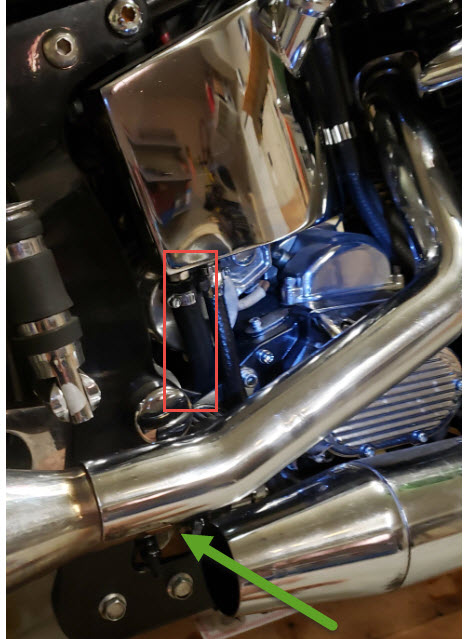

On the Scout, the issue is that the drain hose is nigh inaccessible. Such a tiny space to slip a screwdriver in to slip the hose off the frame plug.

April 14, 2020, 10:02 AM
P250UA5
Here's the oil tank setup on the Scout.
Red box is the drain hose, green arrow points to the tine space available to access the frame plug.
View of the clamp & frame plug
View from beneath, no drain plug here.
Like I mentioned, I may look into a relocate [DIY] kit of some sort to make this easier in the future.
April 14, 2020, 02:01 PM
AH.74
I see a very quick and easy Bubba/Redneck/Hillbilly fix. No kit required.
You could even use the existing line if it's safe/secure enough to tuck away without vibration or touching anything under operation.
Find a bolt the same size as the plug. Cut it to length and file it to smooth it out. Then use that instead of the frame plug, with the same hose clamp. Done.
If you want to shorten the line, pull off the existing line and tuck it away in a tool chest drawer. Take a shorter piece of the same size line and have it just long enough to pull out and pull the plug out, and have a 2" flexible hose you can direct the flow into, the other end of which is in your drain pan.

Yep, something like that is what I'm thinking, but lengthening the drain hose a bit & maybe tying it off to the frame on the side, maybe around where the rear of the shock mounts are.

Here is the left side with the cover off. You can see the bottom of the oil tank to the left, with the drain line running behind the electrics and up to the plug.
And here is a closer shot of the line as it sits inserted onto the plug. Literally, the hardest part of the whole job is getting the pliers onto the little clamp and wiggling it down the line to pull the line off the plug.
It almost could not be made any easier. Your setup with the plug behind the pipes like that is just bad design- IMO. Great bike though.

Well, that's quite different. Luckily, I suppose, I don't have to remove the seat to access the oil tank.
The drain hose being where it is, definitely has a bit of conflict with the svc manual recommending having the oil at operating temp. Good luck getting to pretty much any of the needed parts while the engine/exhaust is warm.

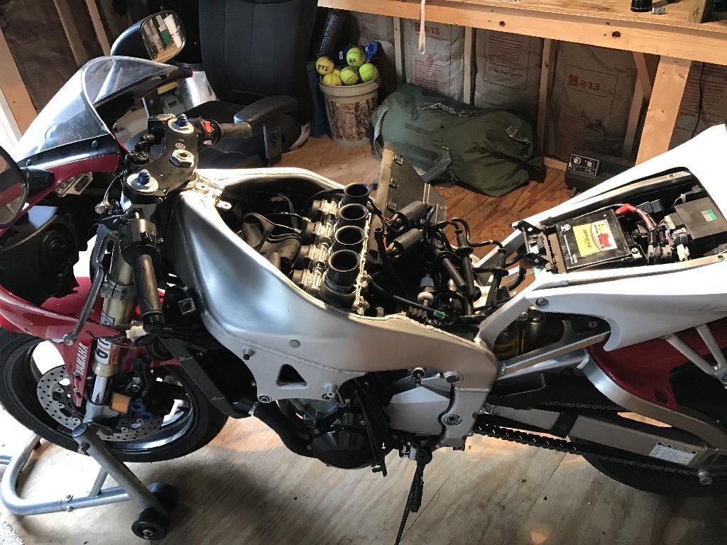

April 15, 2020, 07:40 AM
stickman428
Replacing the air filter on a first gen Yamaha R1 is pretty easy. Yes it’s under the gas tank but you can lift it like the hood of a car to get most of the screws. The back ones are kinda hard to reach but it’s not too bad.
Now changing the spark plugs is a different story. They are hidden under a plastic cover in front of those four carburetors. I had to use four wrench extensions and three of those universal joint things to get a socket in there and pray I wasn’t cross threading them. It was horrible.
