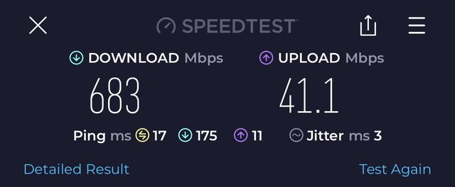

In my ongoing battle with Comcast, we now have the fastest internet we’ve ever had. Speed was never the problem, rather the connection dropping multiple times a day still is.
The upside is I bought a new WAP, Netgear WAX625 on sale for $150, to replace our aging and increasingly unreliable Engenuis EWS377AP. I’m guessing heat was an issue as the cover turned brown in a 2”x2” area. The new Netgear unit is larger with visibly better ventilation and a 5 year next business day warranty.
We had 500mbps service, which Comcast over provisioned by about 10%, so we’d get around 550mbps in the same room as the EWS377AP. However, we’d get under 100mbps in the MBR on the other side of the house and under 200mbps in my oldest son’s room.

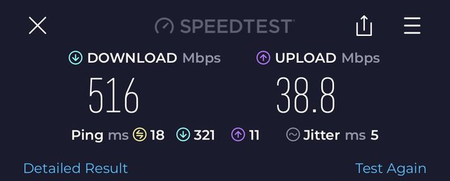

We now have 600mbps service also over provisioned about 10%. In the same room, the EWS377AP was doing the same 550mbps while the new Nethear WAX625 got us this:
Even better though is this in my son’s dead zone:
And this in the MBR:
To be clear, the two from the bedrooms were cherry picked from about five Speedtests in each room. The more usual numbers were between 400 and 550 in my son’s room and between 350 and 450 in the MBR. That’s with the doors closed. But, those are still good enough that for the first time since 802.11g and a 10mbps DSL, I’m using one WAP to cover the entire house.
At this point with Comcast’s service I am 100% sure my equipment is not the issue. I have two TVs directly connected (wired) to their XB7 gateway and both have the same problems along with our wireless connections when the connection drops. There are messages in the gateway’s logs when this happens, but the messages disappear for some reason. I’m getting screen shots from now on.

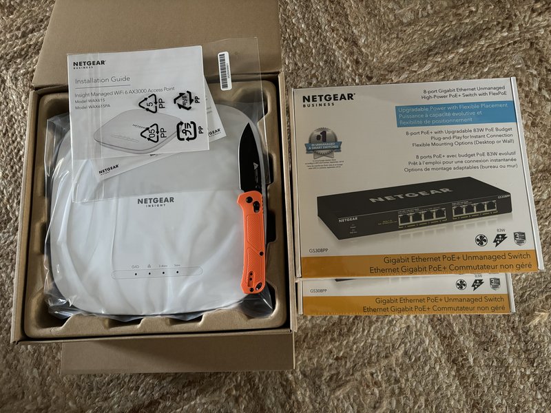

FedEx just dropped off two more WAPs and a pair of POE+ switches:

Your ping (echo packet round trip) times seem exceedingly high for the throughput the "speedtest" site claims. AS well as the discrepancy between IP vs ICMP throughput numbers (if the representation of the numbers correctly represents the test performed). Seems like there is some sort of traffic shaping happening on the Comcast side of things. Testing to some other endpoints might be enlightening, as well as real-life throughput measurements (e.g. the amount of time it takes to transfer a 10GB file).
Posts: 7311 | Location: NoVA | Registered: July 22, 2009Reply With QuoteReport This Post
Echo packet round trip, is that the green arrow? I have another WAP that’s fairly old which maxes out at about 250mbps on 5gHz, however; that green arrow number is around 50ms with that WAP.
I’m not sure what you are referring to IP vs ICMP, is that the download vs upload speeds? If so, that’s the way Comcast’s service works. According to the modem, there’s 31 bonded channels bringing data in and only 6 allowing data to leave. It’s not fiber nor is it Comcast’s newish OFDMA based service which allows for 100mbps up. We’re in the land that time forgot section of Florida. We just got an Applebees not too long ago.
The tests were run using the Ookla Speedtest app on my iPhone which is 2x2 802.11ax for both 2.4gHz and 5.0gHz.
I’d have no way to transfer a 10GB file across the internet. If I sent one from my Dad’s house, he’s limited to 20mbps upload.
Posts: 12990 | Location: SWFL | Registered: October 10, 2007Reply With QuoteReport This Post

IP (Internet Protocol), this is the data encoding that gets it from one place to another. TCP (Transmission Control Protocol), and UDP (User Datagram Protocol) run "on top" of IP to provide reliable circuit-like (ala a phone circuit) and datagram-like (ala a telegram) services. Each of these have further sub-protocols, like HTTP (HyperText Transport Protocol) used among other things to transfer web content and DNS (Domain Name Service) used among other things to translate human-understandable names to the IP addresses understood by packet routing software.
ICMP == Internet Control Message Protocol, this is an IP sub-protocol that is used for network management purposes. There are various flavors of ICMP including Echo and Echo Response (AKA ping) which measures the time it takes for a packet leaving station A to get to Station B and back. This number is known as "latency" and high latency can negatively affect the performance of TCP and others even when there is high bandwidth availability.
In the image shown in the OP, the text line that starts with "Ping" also has a number next to a "down" icon and a number next to an "up" icon. My assumption is that these refer respectively to download and upload numbers specific to the ICMP echo/response dialogue. Since they differ so greatly from the "speed test" numbers, my suspicions are raised that one or the other is a fictitious representation from your ISP which likely has software that recognizes a "speed test" and performs traffic shaping to show their customer numbers that they want to show them.
Note that it is not possible to derive meaningful throughput metrics from the small number of packet exchanges that occur during a typical "ping" session (typically ten or fewer), so why they even bother to show these numbers is questionable.
A "good" ping number is under 15 ms. or so unless the packets are routed through a geosynchronous satellite.
I downloaded a 5.8GB movie from Max in 75 seconds so, 619mbps?
Here’s what Ookla has to say about those latency numbers:
Idle Ping. This test at the beginning of your Speedtest measures the response of a request on your network as if it is not in use.
Download Ping. Latency is measured while the download test is in progress to see how it is affected by download activity on your network, like a household member downloading a large game while you’re trying to work.
Upload Ping. Latency is also measured while the upload test is in progress to see how it is affected by upload activity on your network, like someone on your home network uploading a year’s worth of photos.

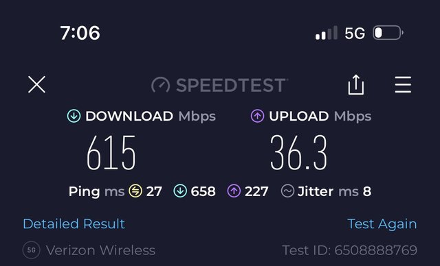

For fun and comparison’s sake, I ran a Speedtest in my backyard using Verizon:
It’s too bad I can’t get that 5G-UW inside my house. It switched to 5G sometime during the upload test.
