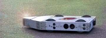

I built an entire Battlebot w/ teaching myself solidworks.
220 lbs heavyweight (because solidworks will also model the weight of everything we could put in the “density” of each material and calculate how much the entire project weighed…
We were 40 pounds overweight in the initial design and ended up reducing the chain drivetrain from 5/8” down to 3/8” and we brought the weight in under the limit.
One very nice option of CAD.
Battle specs:
4 wheel drive w/ 500 foot pounds of drive torque.
100,000 pounds per square inch of impact at the hammer
900 Amps available in a hurry.
