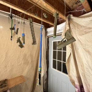

- I did a makeshift spray booth; hanging drop cloths from the rafters in the basement next to the back door; had a box fan blowing smelly air/fumes out and suspended all the parts with 550 cord and pieces of coat hanger. Once dry to the touch I moved the pieces sill on the hangers to the corner of the basement to cure for a few weeks

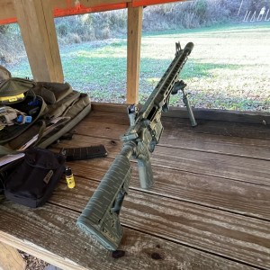

End result:
