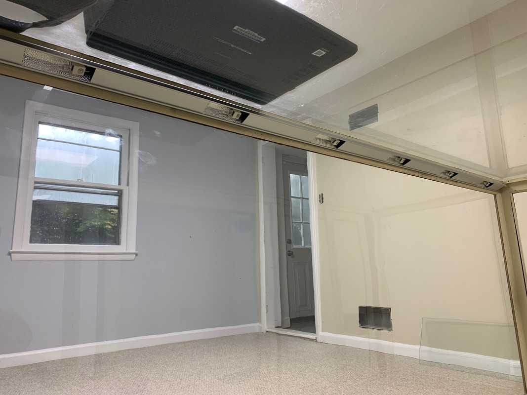

Mrs.BurtonRW and I bought an antique glass display counter/cabinet for her craft room. I wasn't expecting the bonus of pre-installed lighting (nor would I have installed any if it wasn't already present), but since it's there, I want it to work.

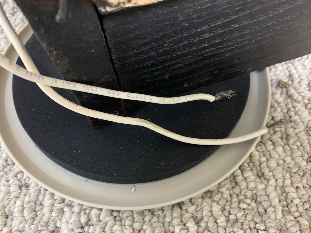

Looks like a strip of half a dozen halogen bulbs. A pair of wires (10 AWG, stranded) run through a simple conduit and out the bottom.
I'm pretty sure I need a transformer for this, right? Assuming so, any idea what specs? Or is it possible that there's already a small transformer tucked into the end of the light strip?

I don’t believe that halogens use a transformer. Im pretty sure they run off 120.
Personally, I would pull the halogen strip and replace with an LED strip. A lot less power consumption, and the LEDs don’t get hot. Plus it’s all new wiring and you don’t have to worry about who wired it before you.

That depends on the Bulb, and possibly the fixture as well. I have low voltage recessed lighting in my kitchen (over the countertops) that use an 'MR-16' Halogen Bulb. There are LV Transformers that are built into each recessed 'can' / fixture.
You definitely need to verify the specs for those Bulbs... Wink

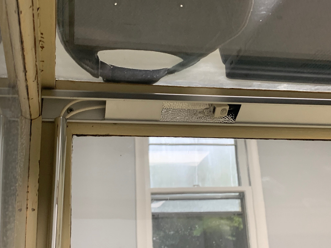

hard to see from the pic, but the bulbs look like 120V appliance bulbs. Verify, like I said, hard to see. There are various 12V DC & 120V AC bulbs - I'm sure there are some in between as well.

Yeah, good call! 10 gauge wire is suitable for a LOT of current. If that wasn’t ridiculous overkill for the installed bulbs, you don’t want that draw on your electricity bill, not that much heat in your cabinet.

Halogen's make a tremendous amount of heat too which is why they need those large wires.

You can most likely find a LED bulb to avoid tearing out what is in there. Kind of hard to see but I think those are wedge type bulbs.

All you need to know is the model of your bulbs. I'm doubting a transformer was in that original setup, probably a 110 v plug was on the cabinet or it was direct wired to 110.

They should be 120 volt bulbs and no transformer needed, you may want to add a dimmer though. That being said they should make LED plug in replacements for the Halogen, which is wise, because the Halogens throw a lot of heat.
